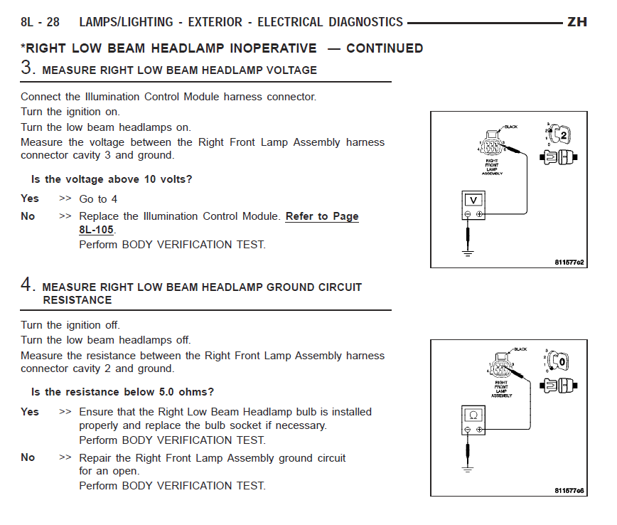

On the headlight out, there are separate fuses for each of the 4 beams, LR - HL

thank you!!! I didn't even think about to that! Thank you for the bet diagrams too! Can you tell me if the fuse panel is located in the cab or under the hood?
The lighting fuse panel is actually a part of the headlight switch, remove the cover on the driver side dash to access.
NOTE : Anyone know why the low beams are on a 15 amp fuse, while the high beams are on a 7.5 amp fuse ?

Would you happen to have the pics corresponding to the left low light headlight fuses?? What you sent is for the right one, and I was mistaken-it's the left one that's out...

Would you happen to have pics corresponding to the left low light headlight? I mistakenly thought it was the right one...
AND THANKS SO MUCH FOR ALL OF YOUR HELP!!!

Huh ? They are BOTH in the above wiring diagram ......

would you Believe that the check engine light went out went out by itself after only changing the gas cap and adding some seafoam, I got it inspected ,the fuse was the problem along with the headlight being blown, and now the back light for the speedometer one of the lights is out in it so- crazy , can't find a fuse for it

and thank you again for all of your help, I don't think my husband would have found that fuse had you not mentioned it!
