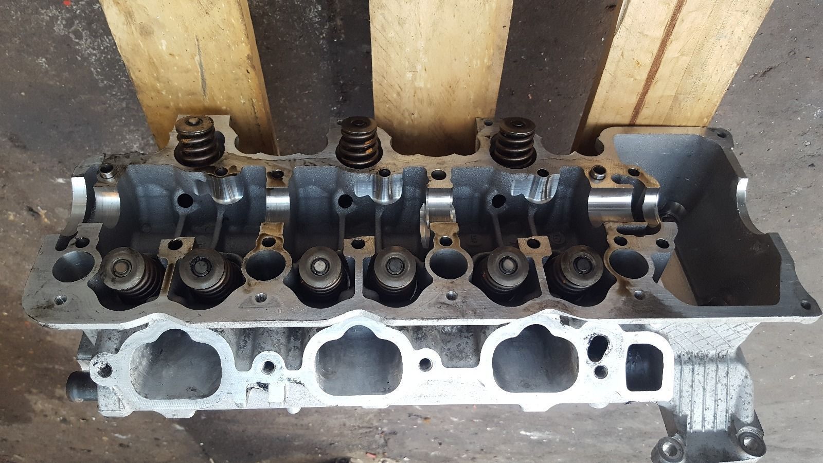

Can you send a picture of the heads and the porting, not that I can tell you what gains they will give you. I just want to have a look. thanks

I have to wonder if they were ported and polished would they not have a valve job and if so would the valves stems be not be faced so they were the same length. There is sand paper marks on the head which makes me wonder more. Woody

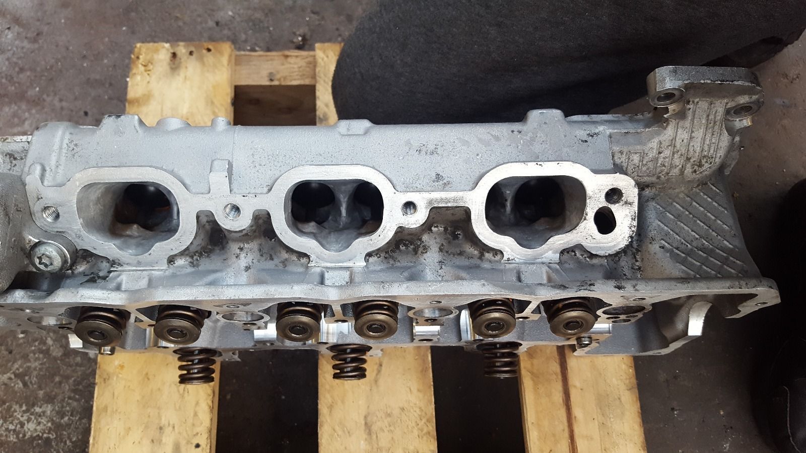

do you have the "married" cam caps? if so what condition are they in? I hope they are not all thrown into a plastic bag to bounce off each other???
pictures 1 and 4 scare me as there are a decent amount of scratches, if the head was slide across a table it will need to be re-decked
pictures 2 and 3 look like it was run for more than 2 weeks as picture 6 shows the head freshly ported and cleaned
picture 5, yes sandpaper and seems to be done after it was installed and removed.
did the seller tell you who did the head and is there any sort of build sheet with them?
once you get them sorted out they should made good power for you. I can help with the needed tools/parts for the swap.

As a machinist and former employee of a cylinder head shop, no professional did that. Every valve stem would be tipped, there would be no residue in only half the cylinders, and the scotch brite scratches wouldn't be there either. Looks like it was done in someone's garage and then laid on a dirty table, only to be dragged off ruining the deck surface. On top of that, it doesn't even look like it was soda blasted.
PS....You didn't overpay. That's about market price for a set. They just don't look like what was advertised.

Absolutely repairable as long as the deck scratches aren't too deep. It would be a $350 job at my old shop, so keep that in mind.

Chuk is is correct... Never had any heads look that, for a better term, unpolished. They should look better than that, not just scotch brighted...or sanded...which looks very unprofessional. I would guess the owner did some polishing with a grinder and brush and called it ported.... Heads have the value you paid. Just may not be ported and the polish is questionable.
