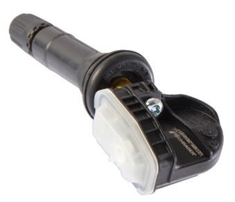

Back in 2010 I listed the Schrader EZ Sensors information but until now I cannot remember anyone listing #33500. I am glad it all worked out for you. The valve stem is a serviceable item and unscrews with the screw shown. You replace it when you change wheels as the rubber seal may be compromised, it comes in a rubber snap in valve body or the aluminum clamp in valve body as the chart shows. To have the aluminum valve body that looks like the OEM valve the snap in rubber valve body is removed and replaced by the aluminum clamp in valve body part #34000 which cost less than $10.
This sensor, #33500, works in both the 315 MHz and 433MHz wavebands and thus serves all Crossfires which can have sensors of either band.
In Canada they cost CDN $62 each at Canadian Tire and in the US $39 at Tire Rack. I know where I will get mine.
Thanks for the update Ron. Reliable by name and nature.
Schrader site on #33500.
See attachment for compatible learn tools.

So what is the final verdict here? I ask because I'm about to buy 4 of these bad boys:
https://www.amazon.com/gp/product/B002GYSM58/ref=ox_sc_act_title_1?smid=ATVPDKIKX0DER&psc=1 https://www.amazon.com/gp/product/B002GYSM58/ref=ox_sc_act_title_1?smid=ATVPDKIKX0DER&psc=1
as this is the OEM part per Chrysler for my 2005 SRT6 based on the VIN! 433MHz sensors with OEM Mopar P/N being 68406527AA.
These are $35/each + tax on Amazon brings me to $151.20.
Now I see this thread and I question if I should just get the 33500's??? They are only $13/each here on eBay... For $52 VS $151.... What should I do? https://www.ebay.com/itm/Programmabl...onW9:rk:2:pf:0
I was reading that for harsher weather the rubber stems are a bit more resilient? The car has aluminum ones on there now.
To the OP as of June of 2018, is your car a 433MHz one or 315MHz? Just curious.
Thanks guys!

What makes you think they are the OEM part? Because they are not.
The 33500 part was determined to be the part to use, just make sure you can get them programmed efore you buy.
