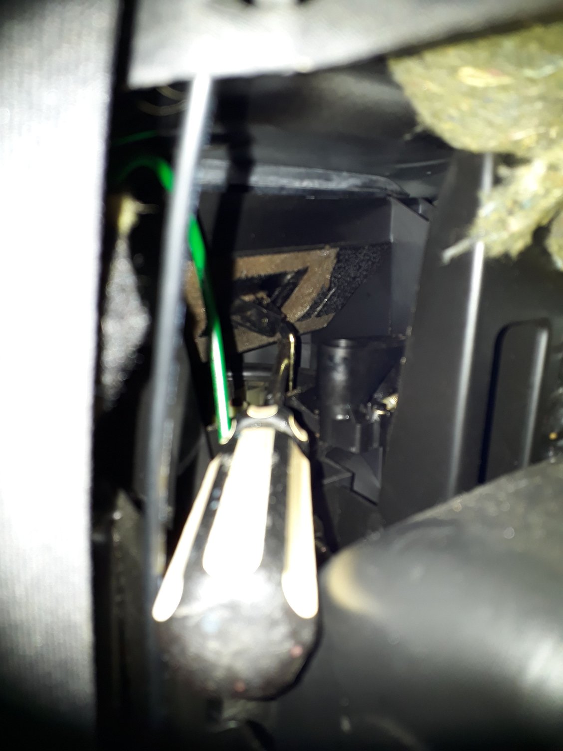

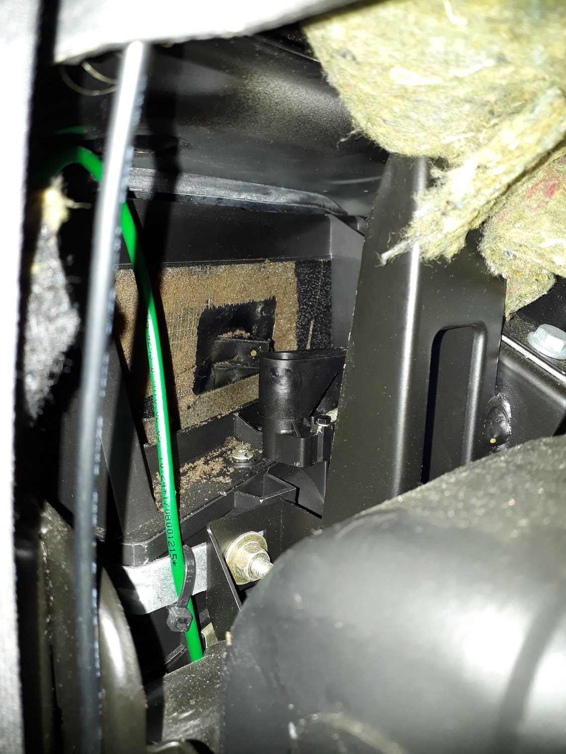

OK, bit the bullet and pulled the air conditioning apart up under the dash on the passenger side.
Pulled the pollen air filter out, pulled the A/C fan motor out, and opened up the side hatch on end of the dash ( faces door)
The pollen filter was in reasonable condition.

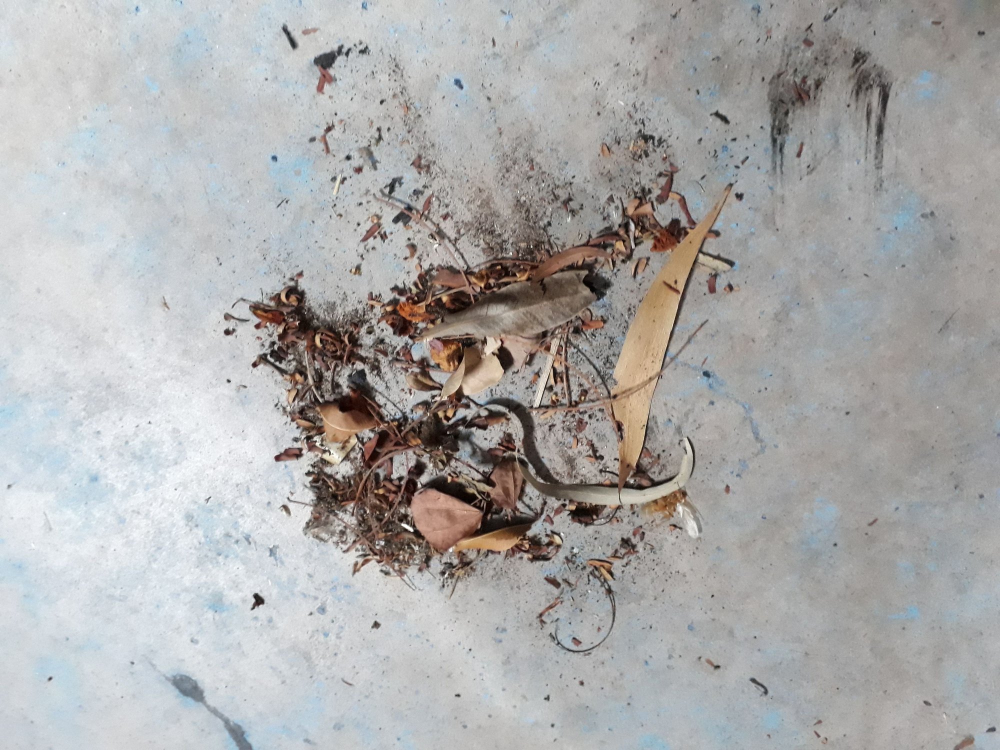

The cover under the fan had a layer of leaf debris on it.

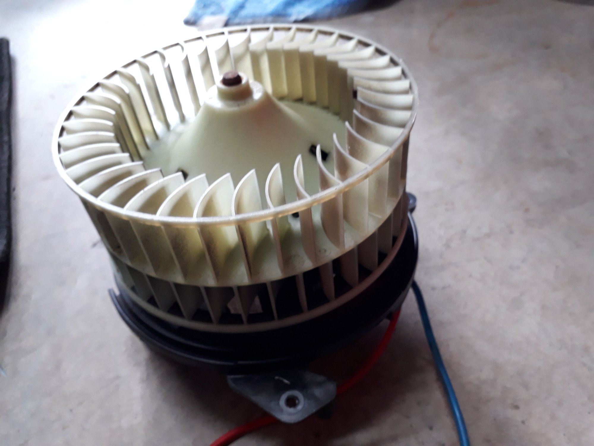

Pulled the fan out.
Looking through the side hatch I could see where the problem was; above the fan air intake there is a flap which seperates the outside air from the interior. This flap is actuated via linkage. The flap has a thin black foam coating on both sides of the flap.
Its this foam which was peeling off and coming out the air ducts.
So I stripped off the foam.
Cleaned the rest and reassemble.
View through the side hatch
Screw driver holding hatch open
View upwards through the fan housing with the flap valve in the centre. Fan motor removed.
Fan cover
Leaf litter from inside the fan housing
