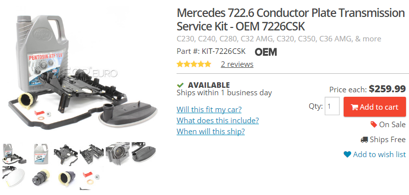

Excellent kit, everything you need ( except the tools and lift ) :
https://www.fcpeuro.com/products/mer...on-service-kit

ala_fire
This kit, is it all that I would need to do the job???
Anything else I should replace while doing this for future preventive maintenance???
Simple backyard mechanic job???
Thanks

Yes, the kit is all that is needed, and I can't think of anything else you need to replace.
I would highly recommend using a vacuum extractor.
Mine is semitransparent, so I was able to mark the level which made it easy to put the exact amount back in.
It is pretty simple, IF you have access to a lift, otherwise very messy and cramped if you have to put the car on stands.
