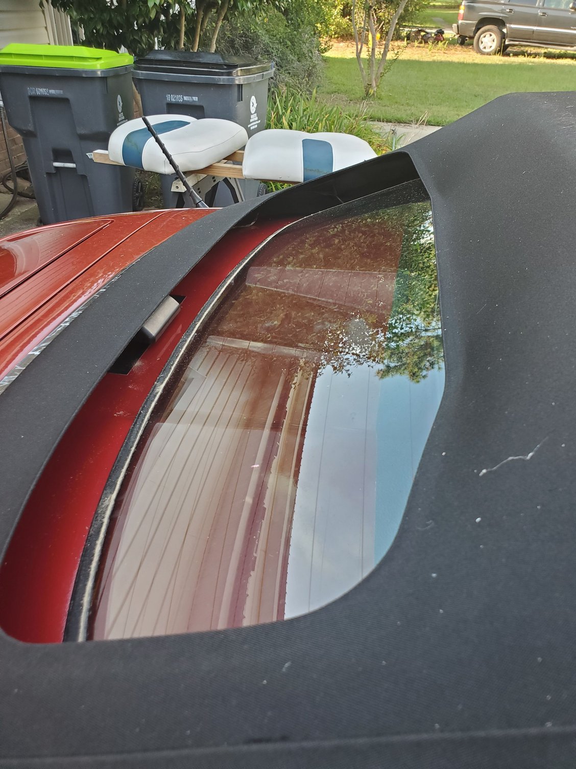

The window fell out over the weekend. I did a glue rush job and suspect that I will be doing this over again. The previous owner said the top was recently done. I strongly suspect that was badly done or just old.

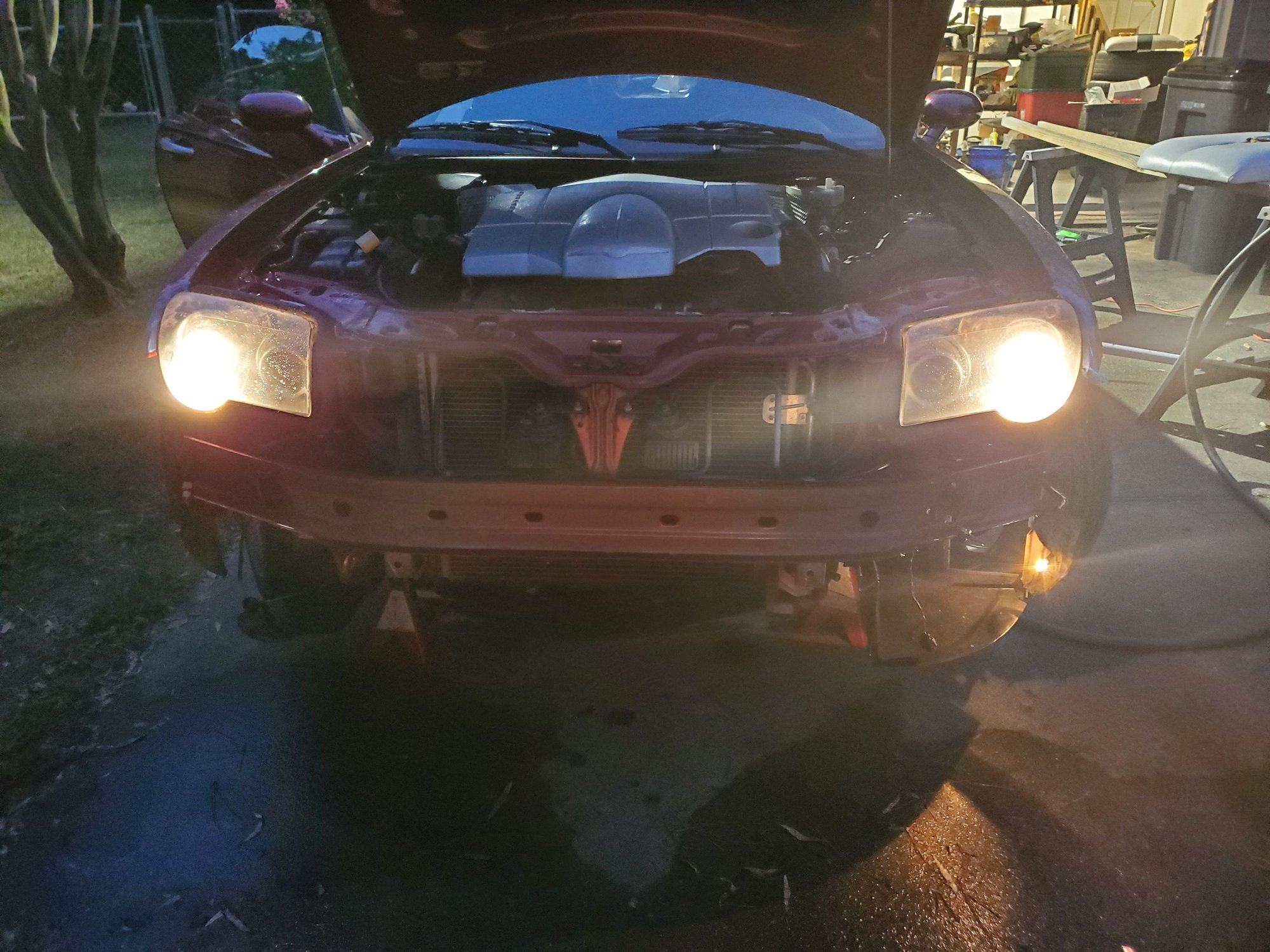

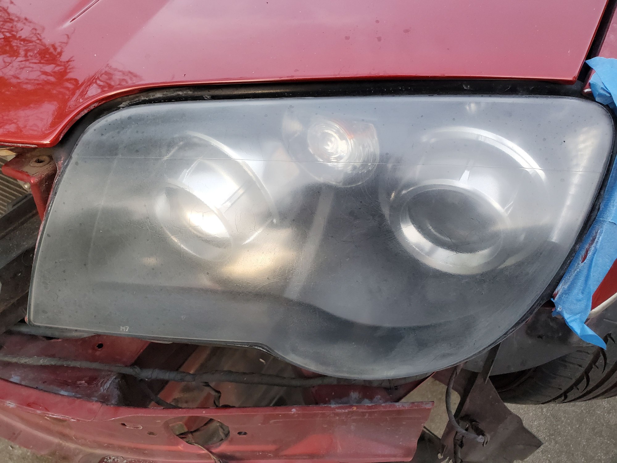

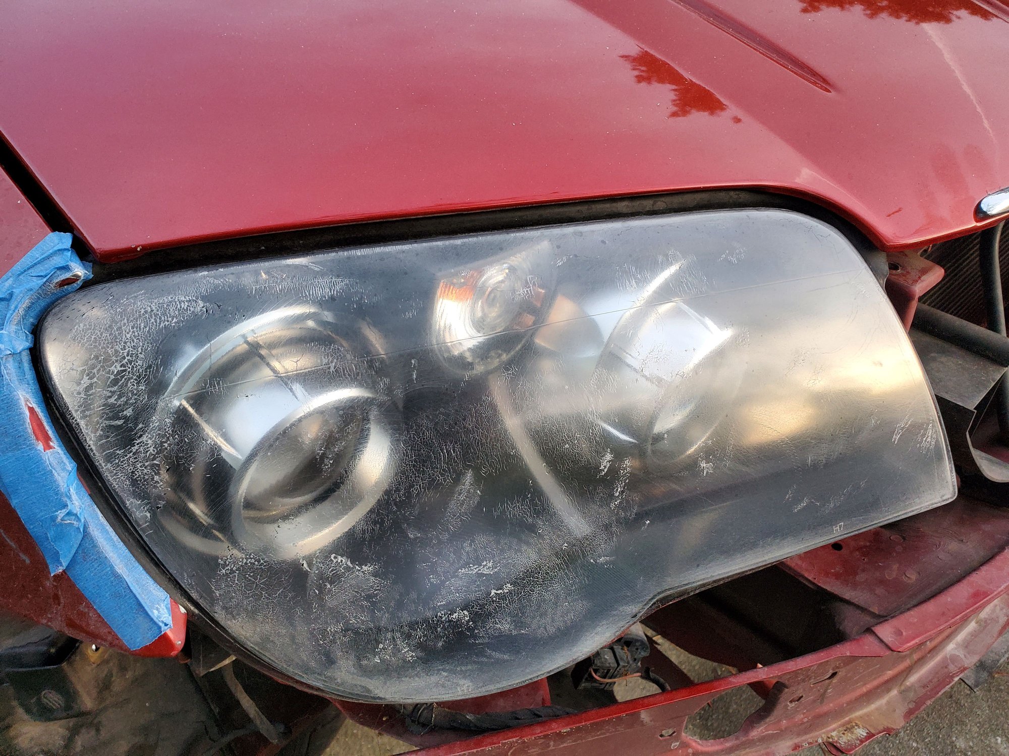

One of the previous owners, smoked the head lights. Well this is a bad idea, when I drove last night, I almost got hit a few times. And I could barely see the road with high beams on. So I will be looking for replacements and just pulling them apart and cleaning out the paint.

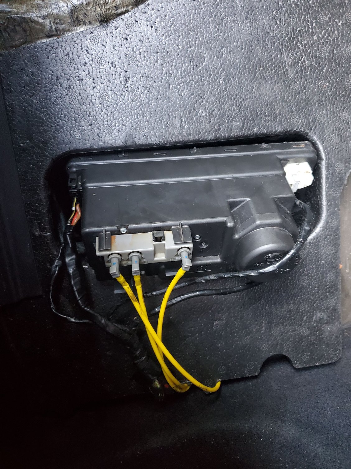

I found this thing, what is it?
Does it have a mounting place in the trunk?

You bought the car from an asshat, but you already know that. Prepare yourself for a long path in getting this car back to where it should be.
You need a new top. BAS in the UK is where you go for them, $800 or so delivered to your door. Zach Joslyn lives near Savannah/Myrtle Beach, in SC, he can replace the top for $300 if you dont' want to bother.
The pump is the central locking pump / security system module (CLP/SSM) and it is prone to water following the wiring harness from around the fuel door, ruining the CLP/SSM. It goes UNDER the foam in an insulated blanket. He pulled it out to avoid water damage or because he had issues making hte top system work. (The CLP/SSM will make the top fail way more often than the top controller.)
The divider switch is a crappy, bad design. MANY of us have bypassed it.
IF you have fluid leaking, you will eventually be sending cylinders to Oregon for reworking, you have leaks and they are not going to get better.
I like those wheels, my car is a base and has no TPMS and thats fine. The TPMS is a PITA and expensive to keep working.

The headlights probably have film over the plastic. Just peal that film off and replace with clear film. A kit is available from XPEL.

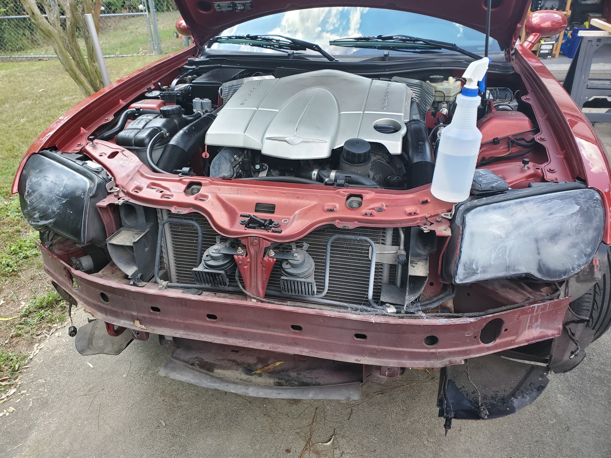

Sigh, I wished; that would have been the SMART move. The person painted the headlights. To do a proper smoke job, it's a light coating on the inside of the lens. Fortunately (unfortunately) the outside was painted.
I took the bumper off to get better access to the headlights. This car was in a front end collision and was rebuilt.
The front with much work.
Closeup of the driver side headlight after much sanding at 400 grit
sand sand sand away

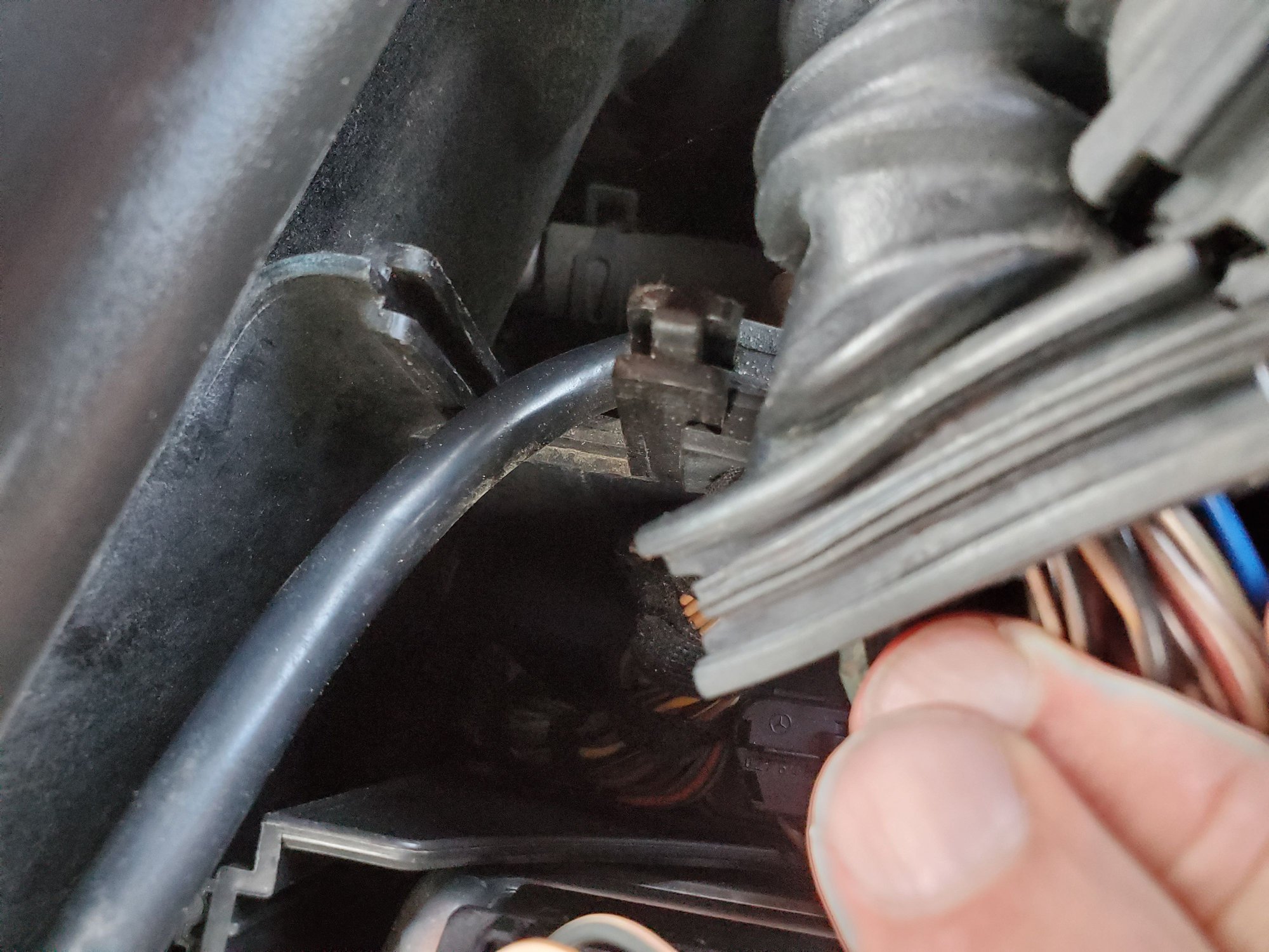

Whoever did something to the positive feed to the starter, ran the stupid cable through the electrical box. GAH!
shade tree tech work, this is not how we do things
I moved some slack around and got the cable back behind the electrical box so I can actually close it.

Headlight update. Got them mostly recovered. I will need a passenger side headlight as it's really crazed and damaged. For now it works and now I can drive at night safely.
I can see the light!
The lights will need a final touch up and polishing!
Passenger side light after sanding.
Passenger light
The driver side light
Driver side
Made some progress on getting my back window glued onto the soft top.
Rear Window Glue Up

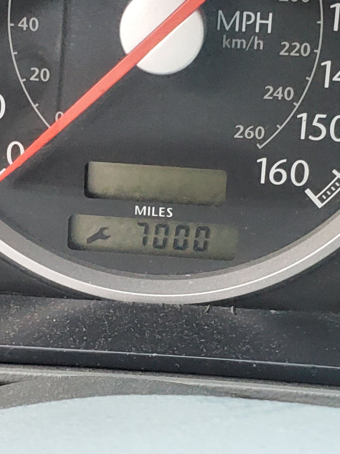

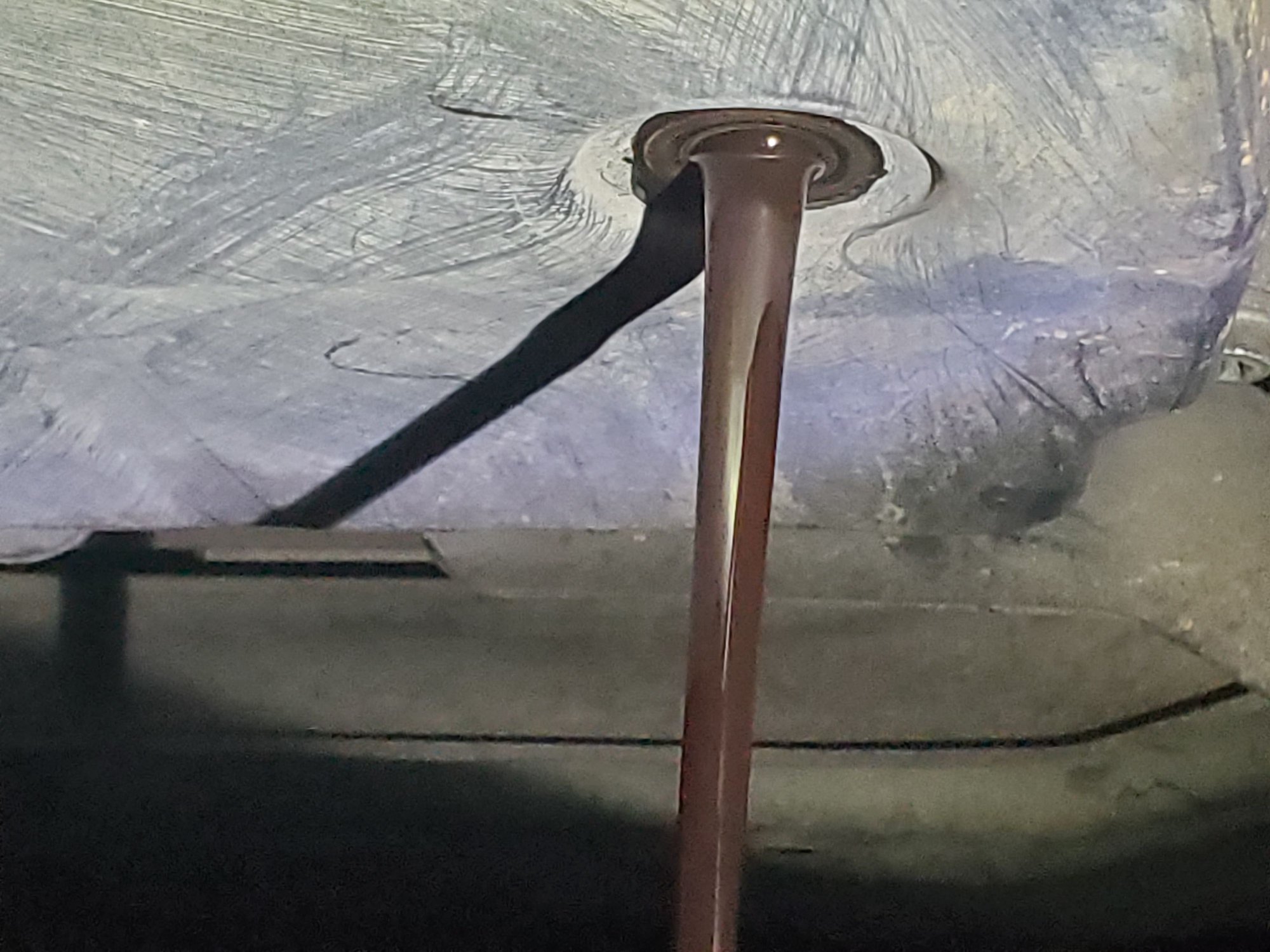

I got the oil changed and my oil counter reset after I changed the oil. The previous owner had overran it by 750 miles.
Now I have started on the transmission. I drained the transmission fluid last night. It looks very tired.
I got the pan off and left it draining overnight. Next i will see if I can drain the torque convertor.
