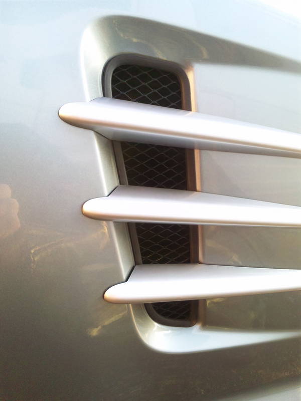

Finally got around to taking pictures of my vented front fenders. All polished aluminium then power coated. Double plated the sheet metal cut outs to exceed the factory strength. Had to make up a scorpion tail styled 304 stainless steel 3/4 gallon washer jug to allow passage for the passenger side vent piping. Reused the origional pump and low fluid sensor. Jug uses all the factory mountings. There's nothing in your way on the drivers side. Will eventually install a narrower battery for the under hood vent. It's kinda close. Over all,there's much better cost effective mods to displace heat. But it looks Sooooo Good! Squirrel Crusher

I've talked about wanting to make those faux vents real. Good job.
But for us dummies, what is the expected air flow and what and how much of a difference is this going to bring?

Those are wicked. How hard was the install? Do you have to take the fenders off?
