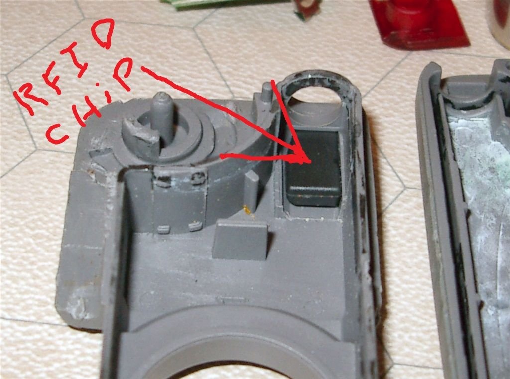

I'm going with ^^^ this is the issue.. when changing out my FOB cases.. the chip has slipped about 1/8" out of position and the car wouldn't start.. I'll suggest tap the fob on the red lens end on the dash then try again when it "won't start"..

The RFID chip inside is programmed to the car when "they" order it.. the only thing left is synchronizing the fob to the car to lock - unlock.. Just like when you replace the batteries and find "fob doesn't work".. covered in the owners manual.. which can be downloaded from here if you haven't already gotten it..
Roll the key to the first position "on" for a couple of seconds.. then you can hit start.. or pull the key out and test "programming" by locking or unlocking.. you should hear the locks - pump kick in.

Just to follow through with something.. you can get a "new" case from Amazon or Ebay for around 10 bucks and transfer key blade.. chip.. and electronics to it for a "like new" key ...

Ok Thanks. You mean for the one I got with the car that’s all messed up? How would I transfer everything?
