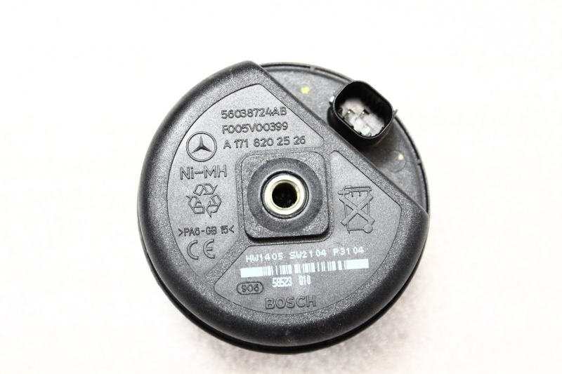

The alarm usually sounds when the car battery is getting old.
Or
The alarm battery is failing.
The battery should be replaced if it is the original Varta battery from the factory. You may have other symptoms of a failing battery, the spoiler may pop up when you start the car for instance.

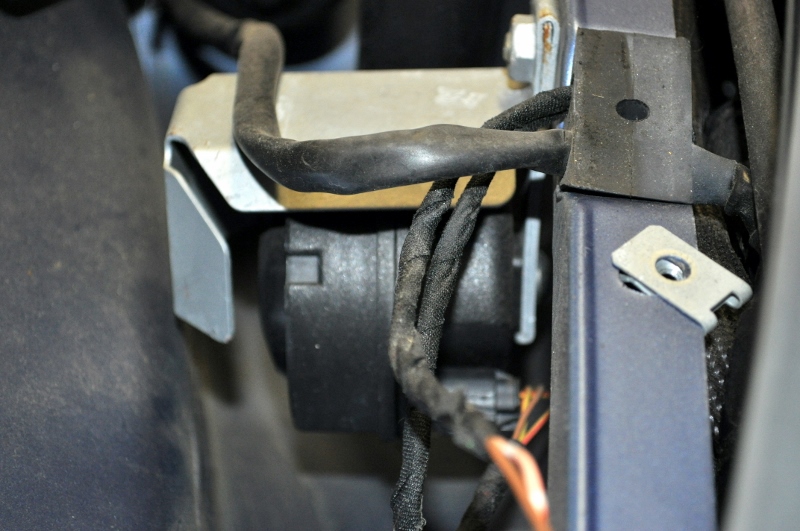

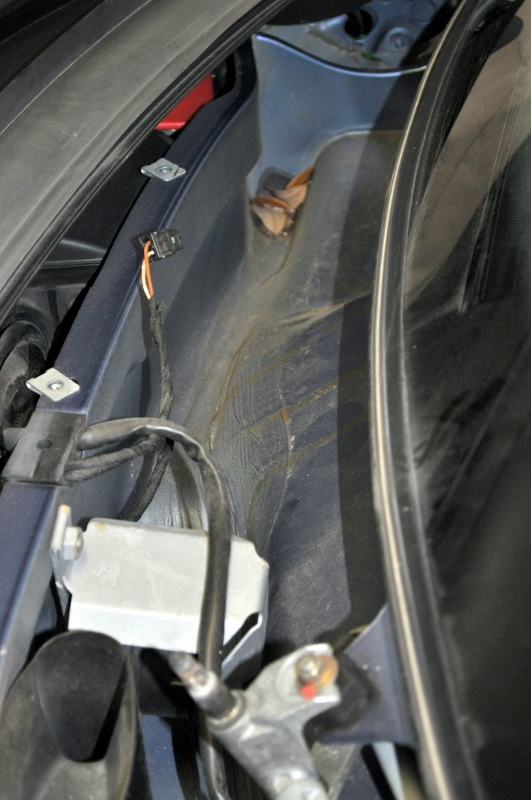

The battery inside the alarm module can be replaced as well with some work. Buying a siren should be easy in Germany, use the Mercedes part number when ordering it as it will be exactly the same part but half the price. The new siren should beep when the car is locked and unlocked.
Link that shows how to replace batteries in the alarm. CLICK
PDF that shows where the siren is hidden and how to get to it. CLICK
