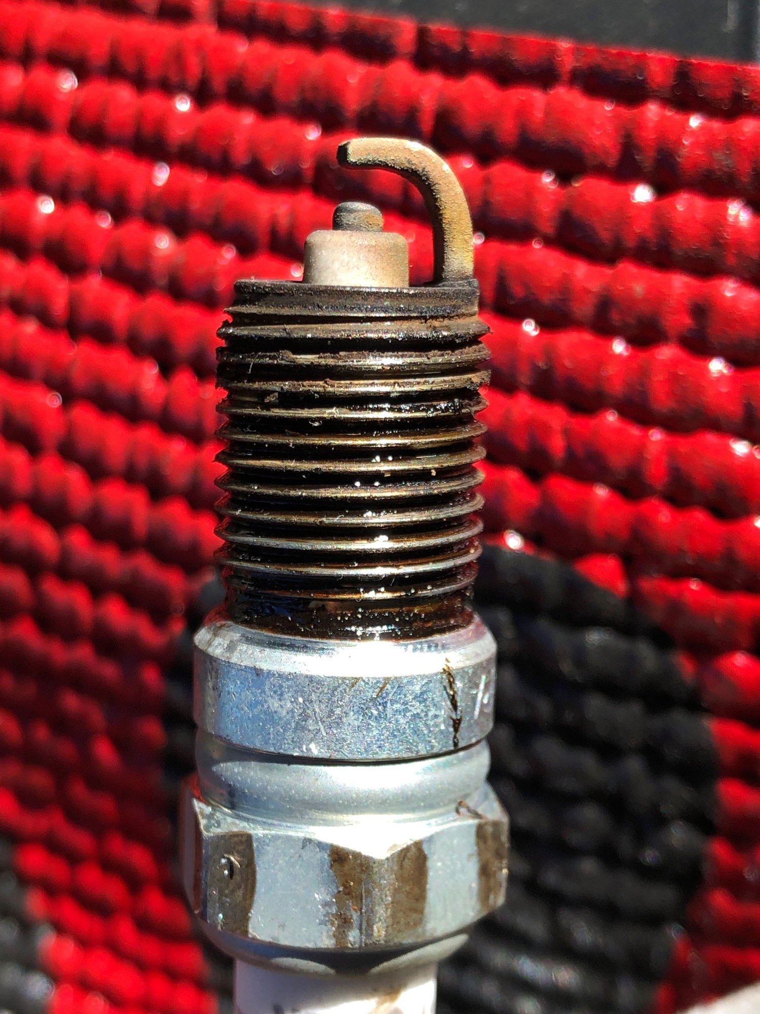

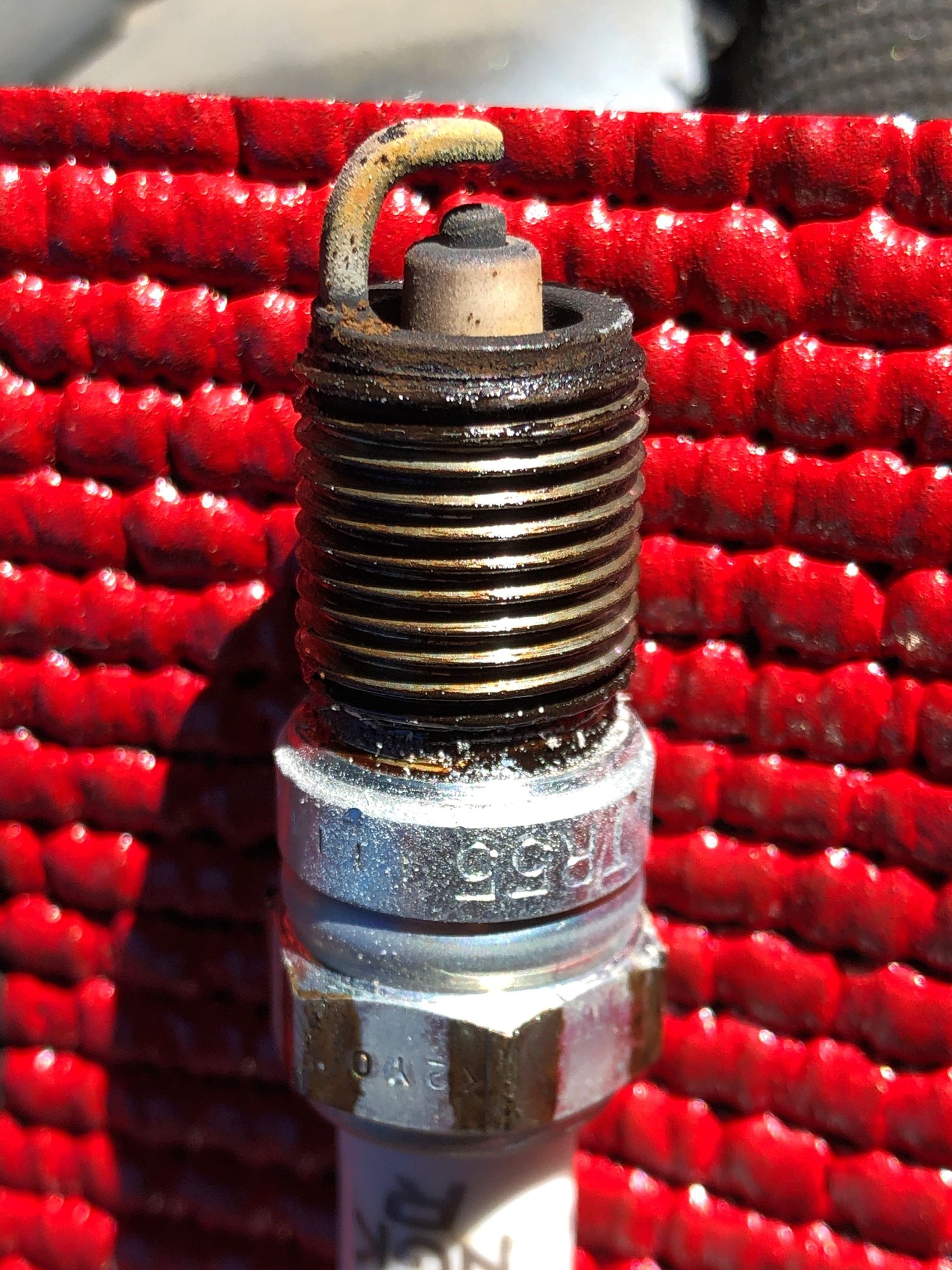

Last evening I had time to pull just three of the plugs. I tested the wires and they look in good condition and tested @ ~2200 ohms each. The plugs (NGK TR55) look good but were gapped to 0.062. I regapped them to 0.40 and reinstalled. This is my daily, so had to get it back together.
I have new plugs and wires on order and will swap them all out when they come in.

BMO >> NGK TR55 is not a recommended plug for your SRT6. Should be NGK plug # IFR6D10 Laser Iridium or a compatible plug to that spec. Go to their web site and search plugs, you will find 7 listings. I do not see a TR55 listed. On their PFR6T-10G Laser Platinum plugs they show a stock number of 5542. Maybe that is what you have?? It does have the gape at .040"

You’re right. The NGK site has several TR55s, but the Crossfire isn’t listed as fitting any of them.
FWIW, Summit does list the TR55 as compatible with the SRT-6, though it is a basic plug. Not the best choice. I’ll be replacing them with Bosch Iridium.
