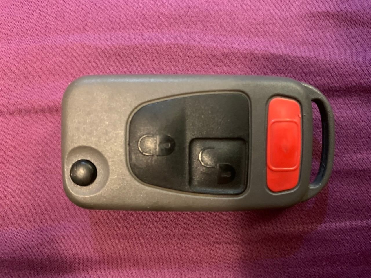

As the title says, I purchased this OEM Key Fob from a locksmith. They said someone had ordered it but never came to pick it up. My luck I guess or “maybe we’ll see”. Anyways, the key was never cut and they said that it wasn’t programmed to any specific car. So I assume it was never programmed to another car? When I picked the key up I had them cut it to the specs of my key. I took it home tried to do the program that’s been talked about on here many time to lock/ unlock the car but can’t get it to work. There was another procedure that I used where you cycle the key three times. Meaning off to run “not start” 3 times and then on the 3rd time leave the key in the ignition for 5 minutes and then pull the new key out then put the old key in start it and then immediately turn it off and insert the new key and presto the car started with the new key. I drove around the block and figured ok it programmed the key to the car. Well, not so fast. When I got back home I took the key out and then tried to start it again and nothing. It turned on for a second and then just died for lack of a better word. Mind you it still starts with the original key. I repeated the steps again mentioned previously in the post and low and behold it started up again with the spare key drove the car 60 miles around the city. Figured maybe it would sync up “better” but it did the same thing as before. Also it still won’t lock/ unlock the doors with the buttons either. It will I lock with the actual key though. Ok long winded I know. Ok now so every time I start the car with my original key and then immediately pull it out and put in the new spare it’ll start the car and I can drive it around no problem. The spare though will never start the car without the previous procedure done first. My question is and I know it’s been talked about many times, but I have not really heard of this specific thing. Can this key be programmed by Chrysler? There’s only one Chrysler dealership here in OKC that still has the Crossfire/Mercedes software to “program” it. All dealerships have been clueless as hell when talking about the Crossfire. And yes I know all about the dealerships and their BS. But I can’t get the new FOB to lock or unlock with the procedure that’s been talked about on the forum. I know there’s a lot to digest here, but any help would beneficial. Thanks guys in advance. Here’s pics of the new FOB as it is a genuine Chrysler key. I did pull it apart to make sure there was a transponder chip also just to make sure.

Thanks for the info. It looks like your partway there. You have an OEM Key FOB from the looks of things. I would go to the dealership and show them the key. If they will guarantee the programming will work, just get a quote. You know the cutting works. My local Chrysler dealership has quoted me $270 for a new key with programming to my VIN and guaranteed to work or no charge. The local Chrysler dealership has been helpful to me with some parts need. I am doing my own service/repair work on the car from the help/input from the forum. So if you can get it programmed for $100-$150, I would consider it a deal I was lucky enough to get a blank key fob from another forum member. I am going to transplant the guts from my cosmetically broken FOB and hopefully that will work. If I do it the transplant without destroying the innards, great. If not I will take them up on the $270 offer for a new FOB. I want 2 fully working keys. Note I am in Canada with a USA VIN# car, because I imported the car from Arizona.. There has been some discussion on the forum about this "US Canada issue" but my dealership is having no issues at all with it.
