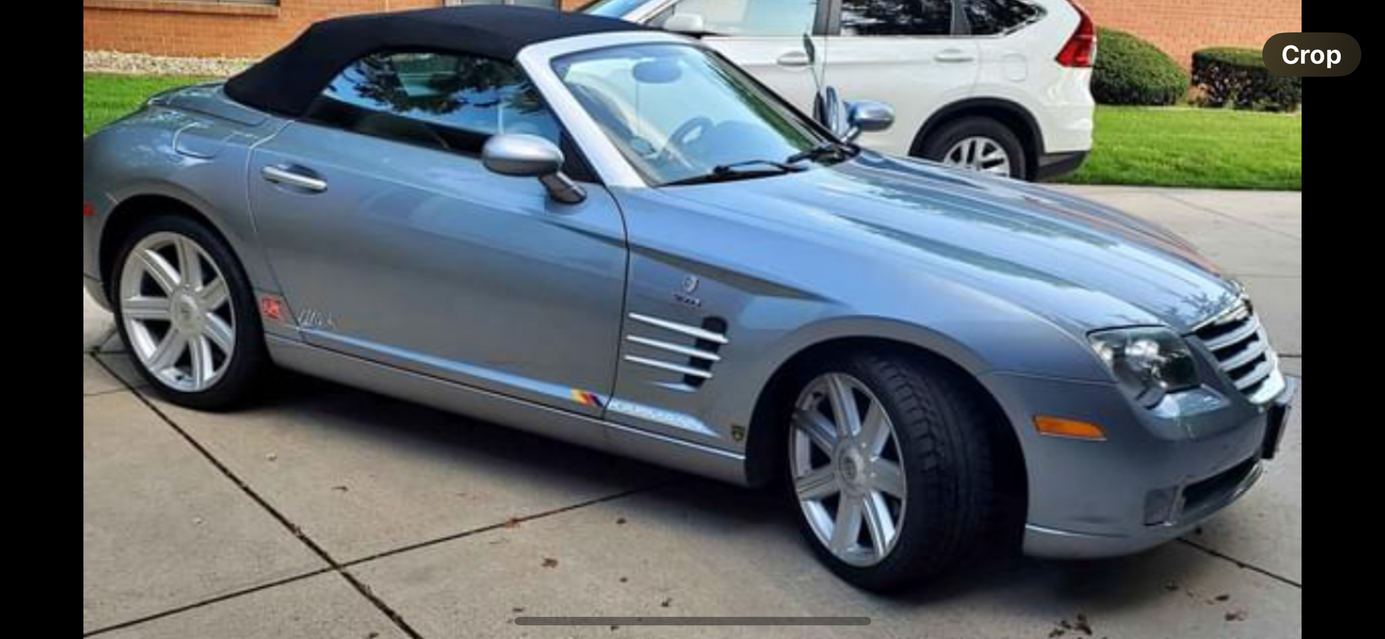

I am new to this forum and new to my 2006 crossfire! My 2006 crossfire roadster limited convertible has an srt6 plaque on the engine. Has anyone else seen this on a similar vehicle? I can’t figure it out! Everything I see and read says if it’s a limited it’s not a 330 hp srt6.

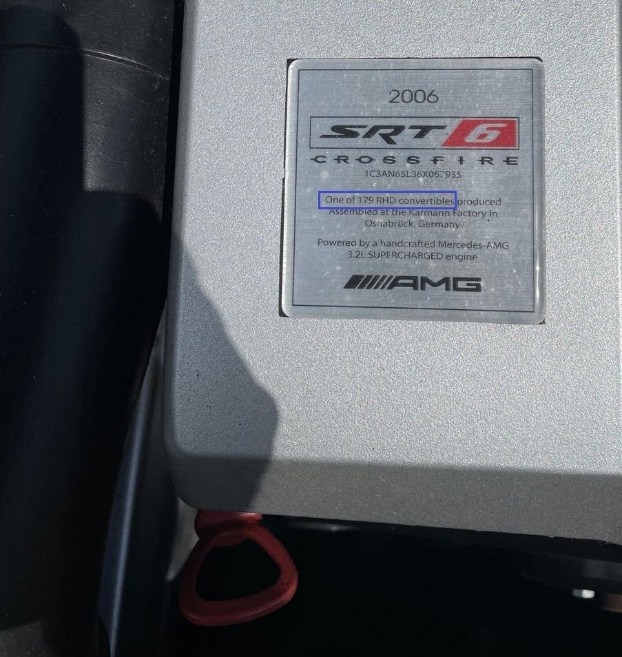

2006 crossfire roadster limited with srt6 plaque on engine.

That is just an add on from the top of an SRT-6 Supercharger. I'll bet the vin on the plaque does not match your cars vin.

Couple things to Note:
A plaque like that does not get placed on an engine cover
A plaque like then is only placed directly on the engine on an SRT6
An SRT6 does not have an engine cover like yours at all.
The plaque shown here indicates a RHD (Right Hand Drive) which is not the car you show in your photo
Someone placed a plaque from another RHD SRT6 Crossfire on yours

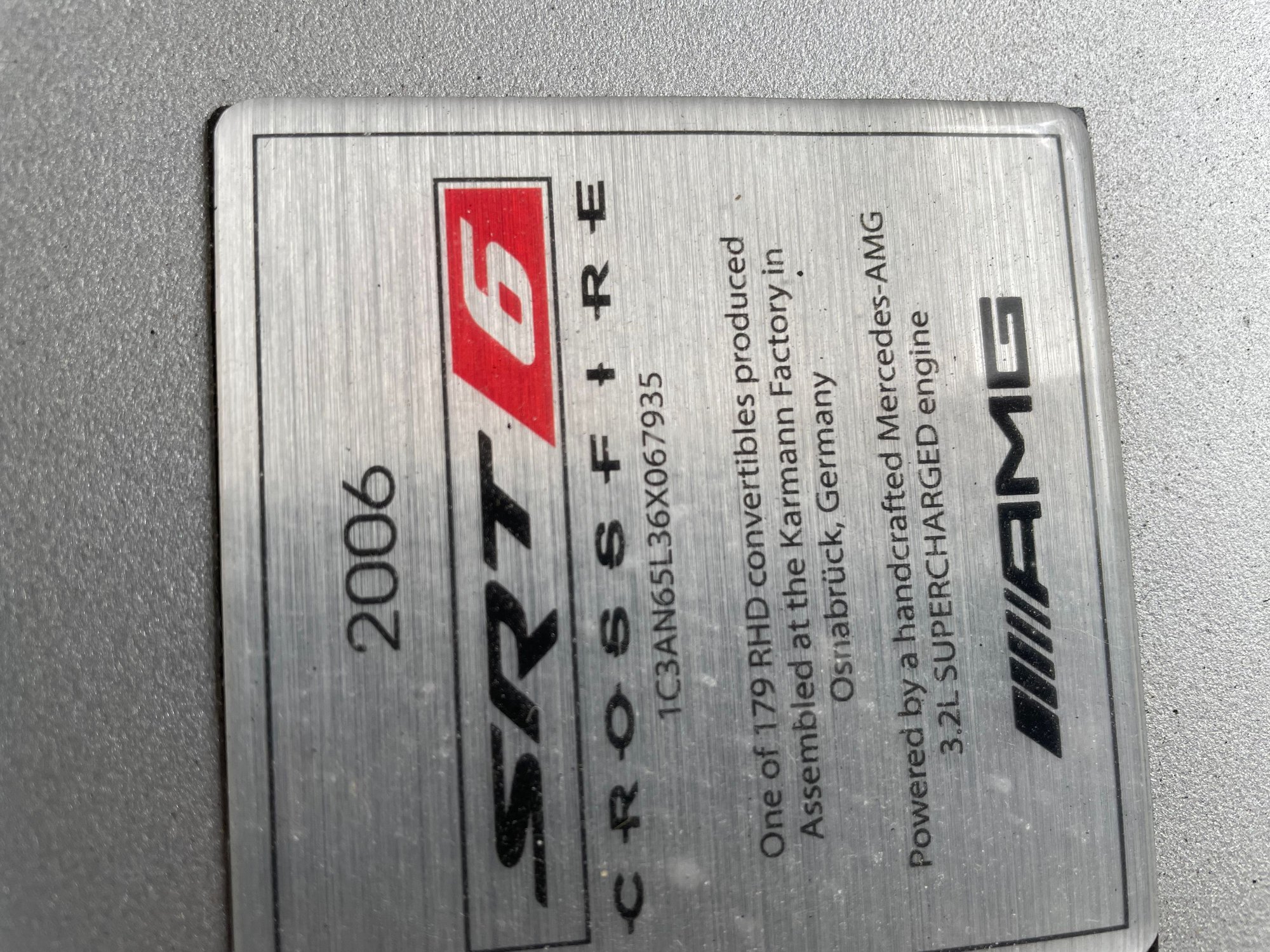

The SRT6 badge/emblem on your engine cover has a VIN# 1C3AN65L36X67935 DOES NOT represent a SRT6 based upon the 6th & 7th digit being 65 which is identifying it as a LIMITED Roadster. Whoever issued the badge for a SRT6, should have rejected the request based upon the bad VIN# supplied by the previous owner and it's a Right-Hand Drive listed as well.
That same owner personalized this Crossfire with at least 5 stickers on the passenger side exterior of your Crossfire. Those exterior stickers never were applied at the Karman Factory upon completion of the car.
You have a 2006 Limited edition Sapphire Silver Blue Crossfire Roadster. You may want to remove that engine badge....
Enjoy your Crossfire, even though it's not a SRT6 model.

That type of plaque is available here : https://beststickers.net/index.php?r...h=33_68&page=7
I used the plaque to cover the hole just behind the hood latch

It looks like a previous owner cut an indent in the plastic engine cover in order to flush-mount the phony engine tag. What a criminal...or a nitwit.

take a look at this link: https://beststickers.net/index.php?r...3_68&limit=100
This is where the engine plate came from
I think it is just a sticker or decal. James

Not with a Vin # I wouldn't think?
