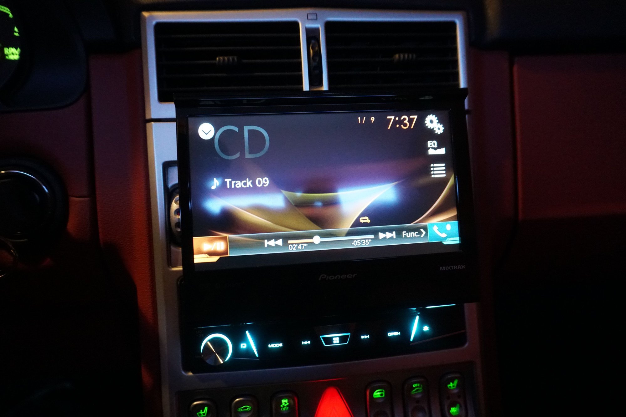

Wow, cannot believe how helpful this site has been in replacing everything car audio wise in my limited roadster. Started out with just replacing the head unit, then decided to replace head unit and speakers, but keep the stock amp and wiring harness to keep it simple.
I decided on the following replacements:
  • PIONEER AVH-X7800BT 7" 1Din DVD Receiver Bluetooth
  • JBL GTO609C Premium 6.5-Inch Component Speaker System
  • Pyle PLPW6D 6-Inch 600 Watt Dual 4 Ohm Subwoofers (2)

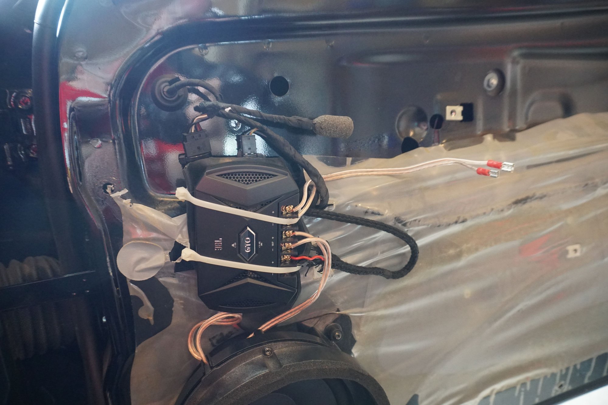

This was my biggest decision and one that I think will help future DIY installers. I choose component speakers with external crossovers over coax to avoid wiring tweeter capacitors. I did several things to justify this to myself. I choose this JBL component speakers because Crutchfield stated the tweeter would replace the Crossfire tweeter. And it was a perfect replacement, popped the old tweeter out and the new one with an included bracket popped right in. No fuss, no muss...
After headunit was installed, I listened to the stock speakers, not bad but OEM lower front door woofers were over powered with bass at volume. I never noticed the subs behind the seats until the Pioneer was installed. The OEM door tweeters could still hardly be heard. Still a great improvement.
I then installed the JBL component speakers without the JBL crossovers. Big BIG improvement, door woofers still overpowered, tweeters were hot tho.
I then installed the JBL crossovers. This was near perfect. The JBL crossovers were installed in each door just behind the interior door access panel that is hidden when the door is closed. I strapped them in just above the door woofers. The crossovers installed was a PERFECT fit and the tweeter was present But, the door woofer was still over powered. I can access the JBL crossover to change settings by just removing the access panel, press tweeter db adjustment button the replace the panel. Plenty of room there for most component crossovers that come with speakers.
I then found the hi-pass 220uf capacitor thread to calm the door woofers down. This was the solution that kicked my XFIRE into audio heaven. Wired a 220uf capacitor between the JBL crossover woofer out and the lower door speaker in. Everything is so clean sounding and I've not yet replaced the subwoofers behind the seat.

Crossover Installed
