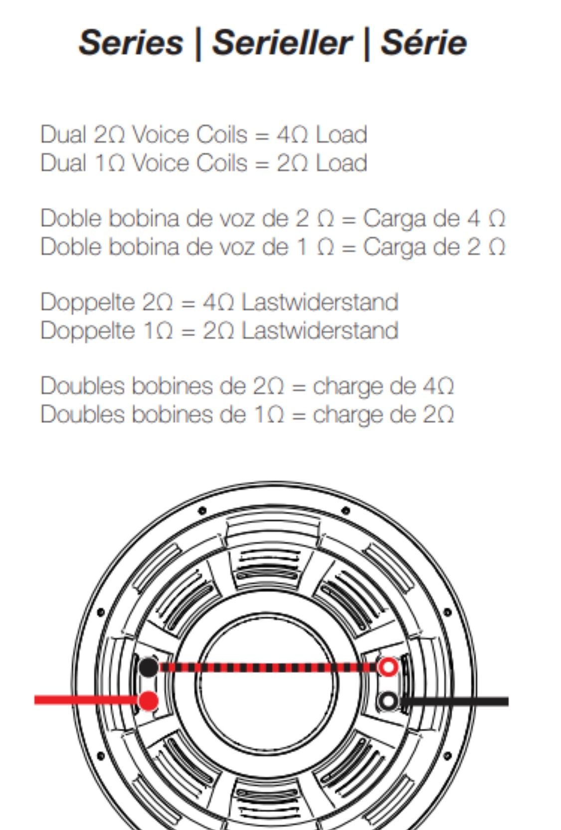

Can anyone recommend rear speaker replacements that are plug and play and can just be dropped in? They do not have to be ultra great. I noticed our has a four wire connector and a lot of speakers only have two tabs to plug into, what is the deal with that? Any assistance would be appreciated.

Thanks, those all only have the two point hookup and the crossfire sub woofers have four wires.

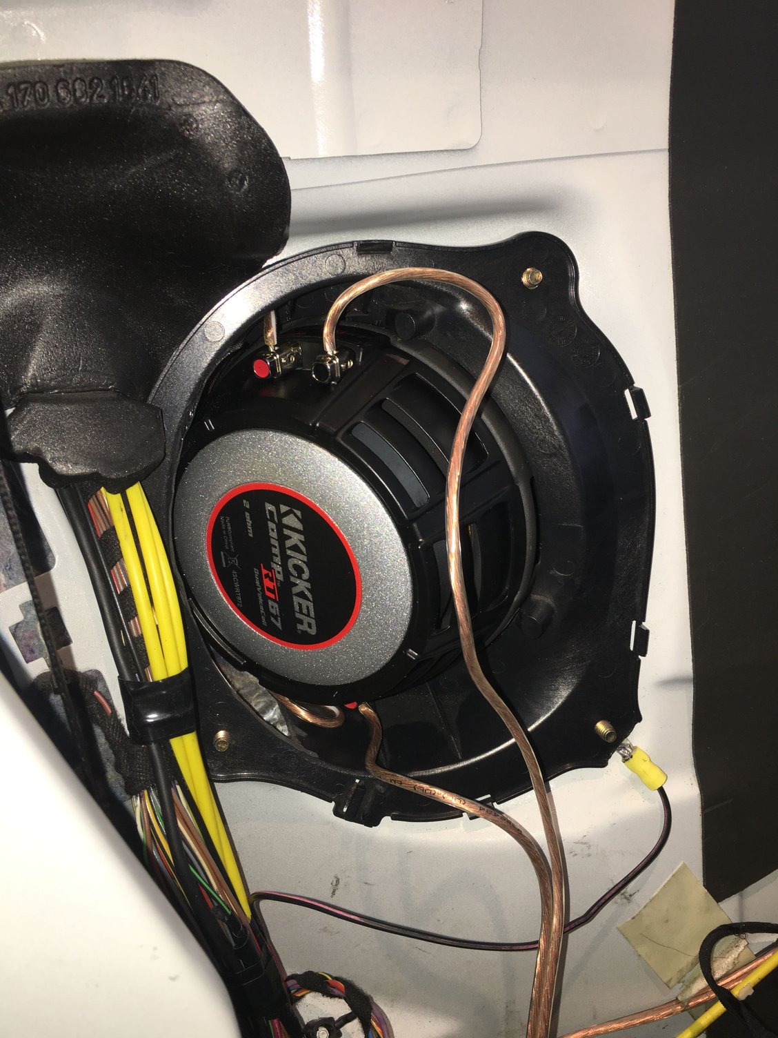

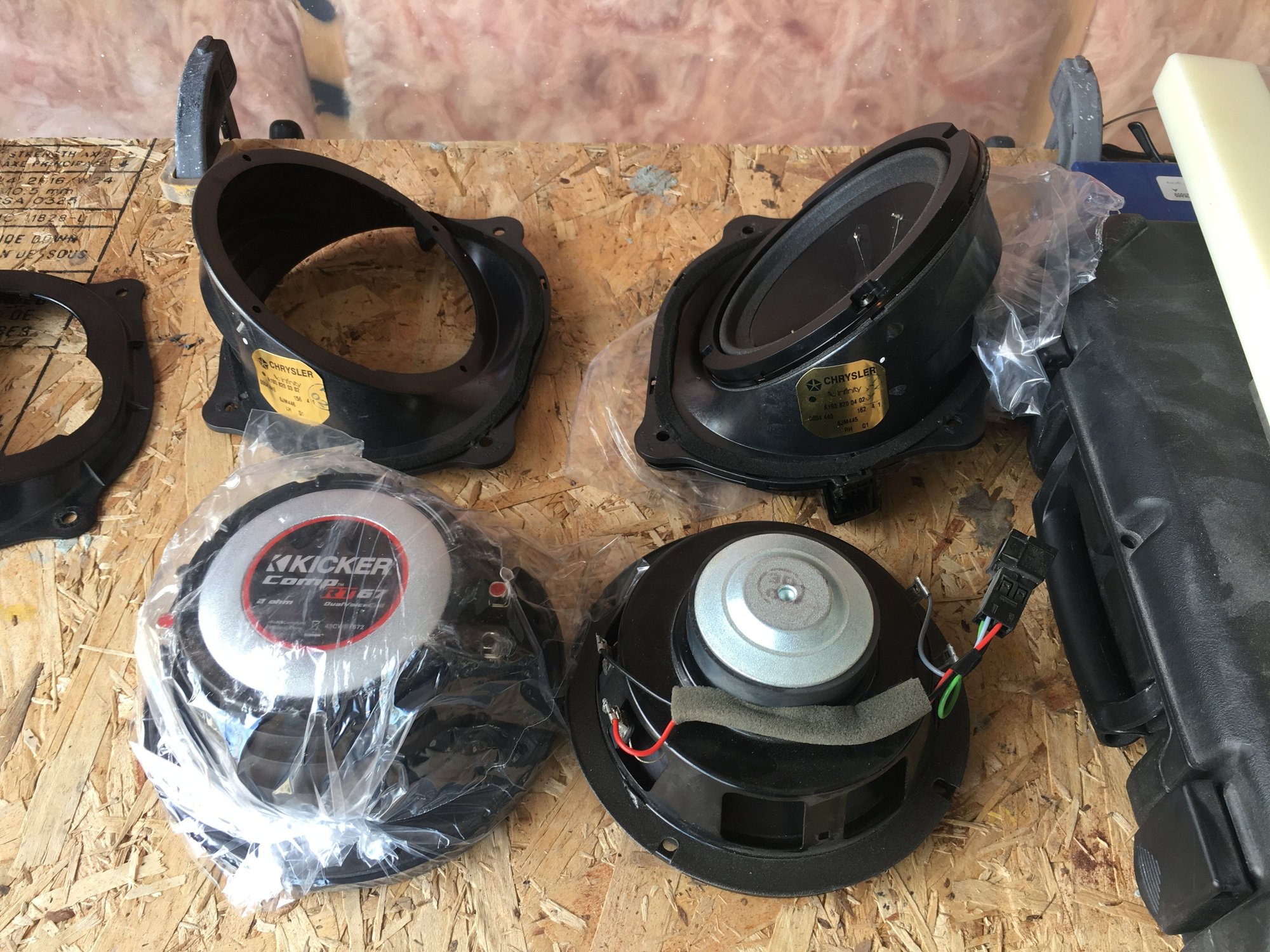

Kicker is not a 100% direct fit. Right size for opening
a spacer and some cutting is required
lots of information on the site

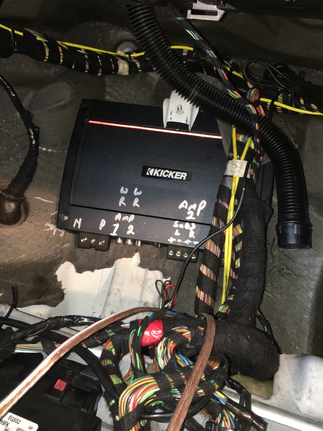

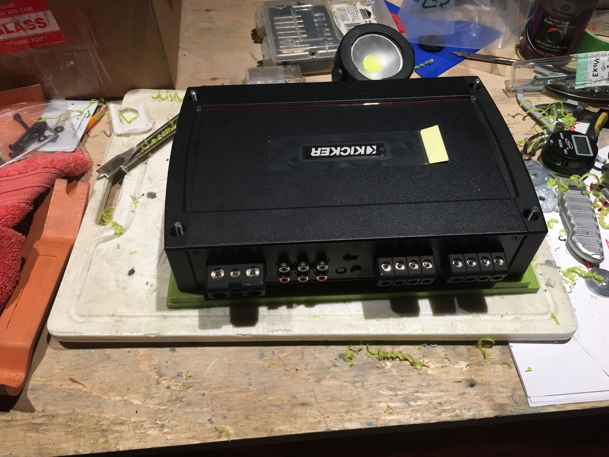

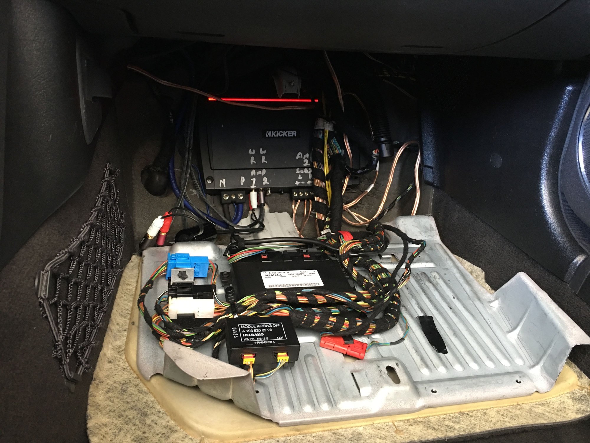

Although a new amp is not plug and play, it’s worth it if your going to install new speakers
