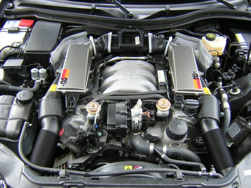

for the intake, AMG C32 or SRT-6, setup a member by the name of Cincinnati Slim posted the following:
Here are the part numbers for this set-up...
Air intake tubes from radiator area to air boxes, Benz and Chrysler parts numbers as follows...
A 112 094 15 82
05135452AA
and
A 112 094 14 82
05135451AA
The rest are M-B/AMG numbers on the parts...
MAF "Y" pipe...A 112 090 01 29
Rt. Flex Tube...02 6367 A
Lf. Flex Tube...02 6367 B
Rt. Airbox...A 112 090 1001
Lf. Airbox...A 112 090 0901
And here is a picture from his gallery showing the setup he is using:
i found it in this post: https://www.crossfireforum.org/forum...?t=9375&page=2
looks like the dealer is your best bet or try and snipe one from a salvage yard (very unlikely).

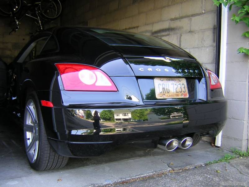

for the magnaflow exhaust, Cincinnati Slim comes through again (before magnaflow had a picture of their own product up i may add):
hey Slim, if you are reading this, thanks for bringing so many pictures of your exploits to the forums ... much appreciated!
