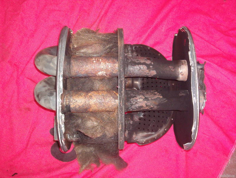

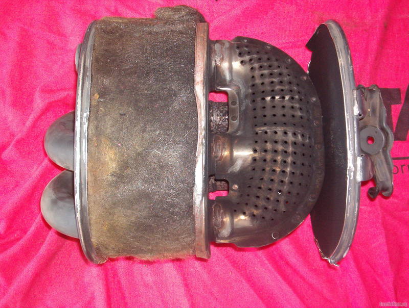

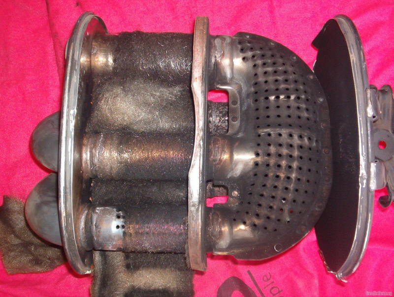

Default FACT: You can't make more power with an aftermarket muffler...
Because the stock muffler is sooo efficient, and flows sooo much air...
Discuss

Having some knowledge of hydraulics every bend reduces flow, maybe a little but straight thru means unrestricted flow

LMFAO.......that looks like a Johnny Carson map! (for those that remember Art Fern here's a video to bring back memories. the 5:15 mark is the map portion! http://www.youtube.com/watch?v=8HXkfDeR9Nw)

I was wondering what the inside of the OEM muffler looked like. Damn, that looks like a mess! Thanks for the pics!

There is deffinately an increase. Most notable RPM range over 4500

well, Im not exactly an expert on this, but I have had alot of experience working on turbo cars, and from past experience, it really depends on how much boost you are running. The more boost, the larger diameter pipe you need to run, thus, allowing better flow to the turbo. Since boost is basically forcing air in and out of your engine. The biggest restriction on XF's is probably the cats, since there are like 3 sets of them. But since you can't remove those due to emissions and OBD2, your only real choice to open up your exhaust flow would be the muffler, and I can tell you right now by looking at the factory one, its a piece of junk, its heavy, the exhaust flows into, out of, and then back into, and finally out of the muffler. I installed a custom exhaust on my XF, I had my best friends dads drag race team install a 8 Inch (in length) 3 Inch Inlet Single chamber to a dual 2.5 inch outlet drag muffler, and I could tell a huge difference. Especially in throttle response. I even ran it with straight pipes for a while, without a muffler, and it really opened it up, but the neighbors didnt like it to much. But, everyone has their own opinion about sound, performance, etc.
With a muffler like the stock one on the xf, you create a bottle neck effect, causing back pressure, which in some cases is ok, (small displacement engines), but the xf 3.2 is a fairly decent displacement engine.
