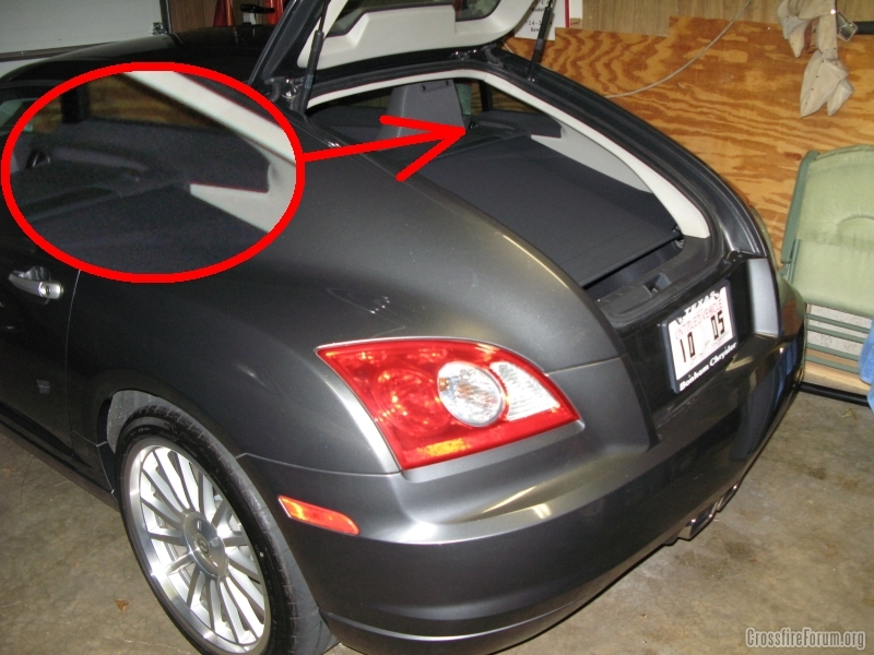

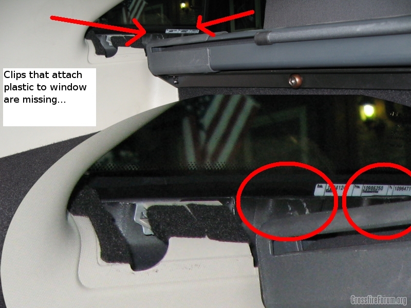

I have recently had a bad experience with a car stereo shop, and am in the process of rebuilding my hatch area. I ordered three new clips for the windows where the seatbelt trim piece attaches. (attaches plastic piece to bottom of quarter window)
picture soon
When the dealership ordered the clips, the wrong thing came in. It is the correct part number, but the wrong one is listed in their computer. (a windshield wiper clip is the part listed) The dealership said that if I can find the correct part number, they will order it.
Does anyone out there know can I find part numbers, if Chrysler doesn't have them?
Thanks,
Alex

I wish I had the part number. I am out of state on temporary duty for the Air Force right now, so I don't have it handy. On the illustrated parts break down my dealership uses, it is not shown, just referred to. The illustration gives a part number, but when the number is typed back in, will show a $10 black screw clip for the windshield wiper. This black clip with a screw hole is not what I need. I will try to do describe the clip I need with pictures I have on my computer:
The clip I need looks like the silver clip above, but attaches plastic parallel to the window, not perpendicular. I don't know if this helps, but thank you for taking the time to respond.
