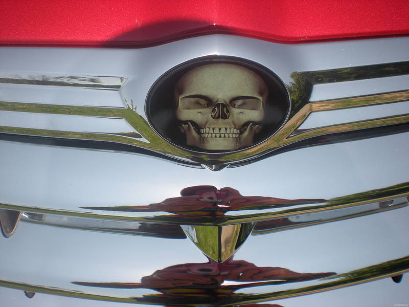

Ive covered the front and back with my skull decals, 9.99 on ebay, search for chrysler emblems. Anyways, Ive had several times when old guys, 70's etc, not "old" like Franc , do a slow walk around trying to figure out WTH kind of a car it is!
At every carshow Ive been to I get asked "what is it?" I just want to put more mystery into the car. Honestly, many people dont know about xf's or have forgotten them. I do like the lettering, very classy but I like different/odd better
PS, I got an extra set of thee decals but honestly theyve held up fine for 2 years!!!
