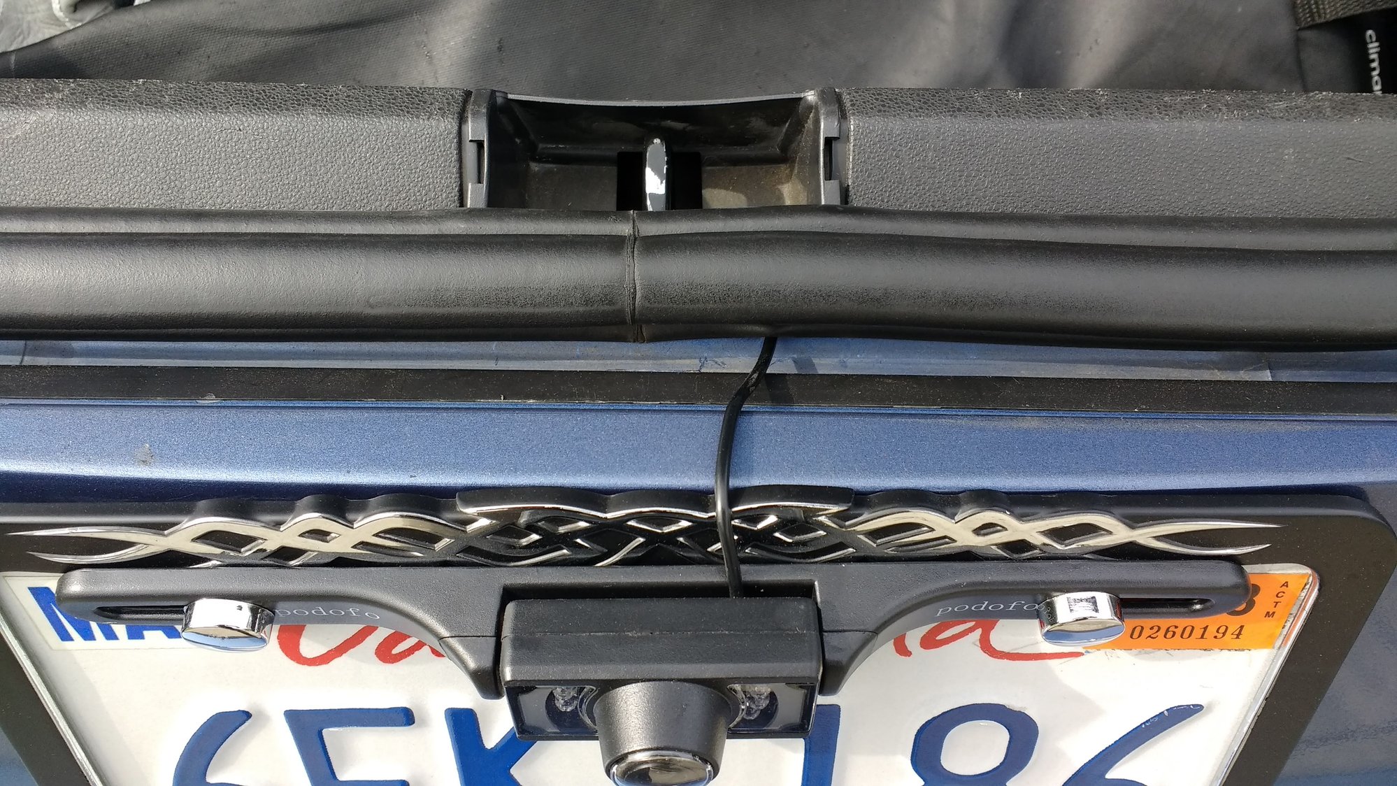

I looked at the same thing when installing my back up camera. AS far as I can tell there is no passage through the bumper molding into the trunk. The hole is to access that bolt which I think is part of the trunk latch. I opted to go under the trunks lids rubber molding and behind the plastic panel at the back of the trunk and over to the back up light. The wire for the back up light is Gray with Yellow stripe, although from the plug connector to the light they just use plain wires. I opted to pacth into the Gray and Yellow wire just before the pug connector. Good luck.
