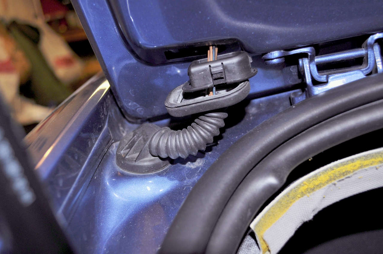

So I looked at the hose and the seal. And it looks fine to me. But maybe I also don't know what to look for..the top part that attaches to the hatch and the bottom part that attaches to the body seem sturdy and tight.
I worked super late last week so haven't had a chance to look for micro tears. Is there a trick to look for years or where water enters the car?

Post a pic if you can of the seal to the hatch opening, it may not be seated properly allowing water to come in and soak your headliner.

So here we go...the leaking side (driver side) doesn't look like the hose is damaged even though there could be micro tears in the hose I don't see.
That is definitely the area where water gets in though. It seems the attachment points are solid but I'm pretty sure Florida sun did a number on it and water is actually getting in where it's attached to the body of the car. (See pictures)
Now as for the right side (passenger side). I have never noticed the headliner to be wet on that side but it looks like the hose is brittle and has deteriorated. That is also a cause for concern and I hope that wasn't enough to leak into car and damage electronics.
Lastly, on the leaking side the headliner is hanging down pretty bad. I guess once I get the clips I recently order for the beige trim panels that problem should be fixed unless the headliner panel attaches somewhere?
These trunk rubber hoses and attachments freak me out. I have no idea how long it's been leaking into my car through there and what damage it's done to the electronics.
How do I go about fixing both sides? Where would you start?

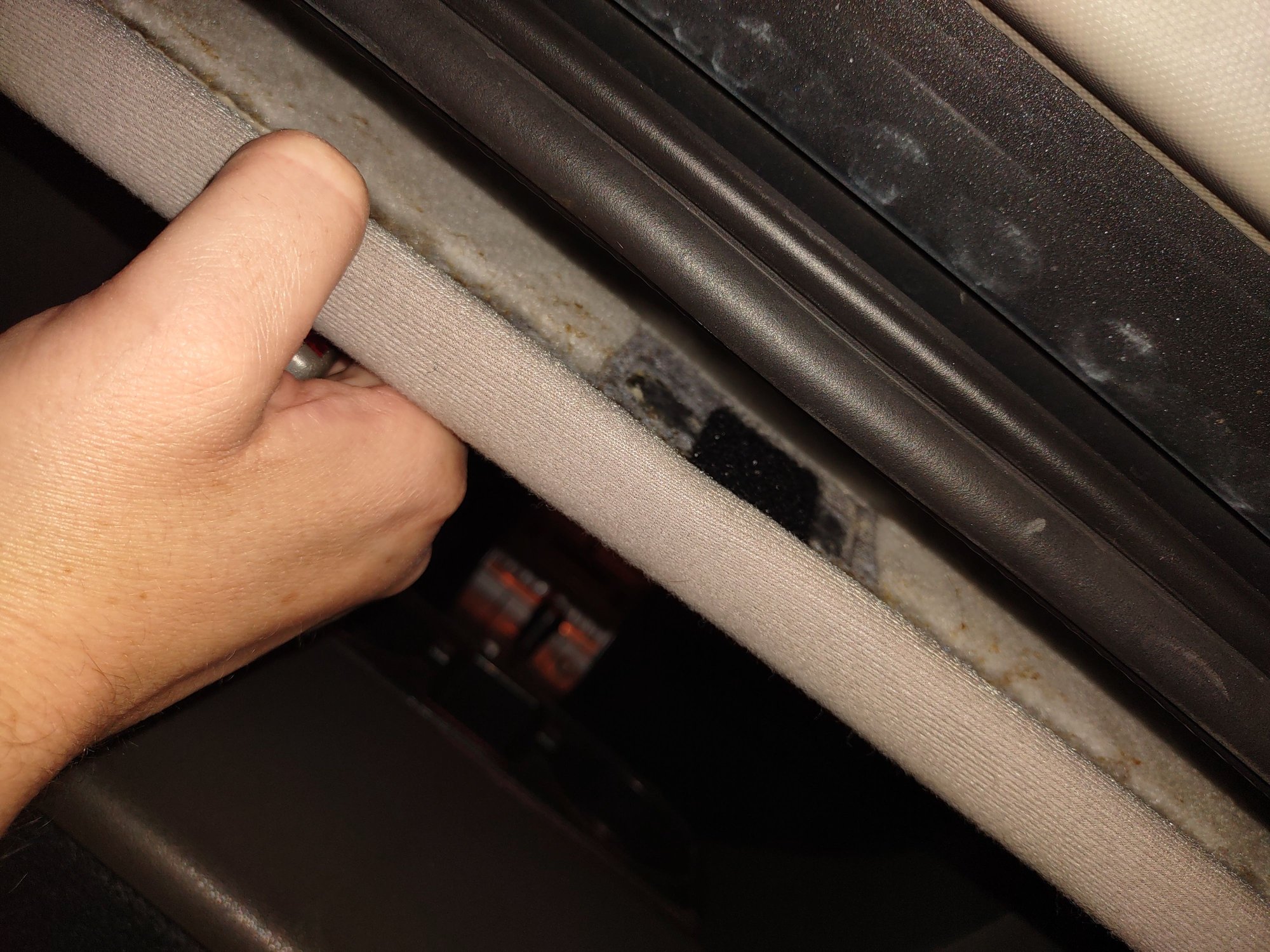

Also could water get in through these trim pieces running along the roof of the car? This one seems slightly elevated

The rear of the roof liner is held up by the same type of retainer pin as the ones that hold up the carpeted sections in the trunk. There are one on each side and they are hidden by the forward portion of the hard upper trunk liner.
Would you be able to post a picture? I looked but can't see that screw/clip. I know exactly what clip you are talking about...it has two parts to it, black plastic.

That’s the part, I cannot stake a picture as the rear upper liners are in, the clip is more or less under the rubber conduits that are leaking, maybe a little in front of them. The holes for them may show up in a photo of the roof liner being recovered.

It's dark outside but just went down to check and I feel like I feel two holes where those clips would probably on the body of the car but I see no openings on the headliner for those screws to go through or attach. Makes me wonder if previous owner had headliner redone and they just glued it in and never really used those clips to attach it. Maybe I'm just not looking at the right thing. Will check by day
This photo shows the holes. The bottom left photo shows a hole in the bottom right corner of the liner where there is no flange on the liner and the corner is square with a radius in the corner. It is a flat area. there is one in the left hand corner as well of course.
And how do I best attach it? Would I need to take the whole headliner out? Here is what mine looks like it...I don't see openings for screws so almost feel like maybe person before me has headliner re-done and the glued the panel in, because there is glue like material all over the fabric.
