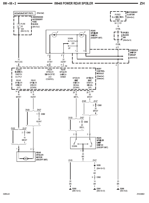

Okay, I removed fuse number five for the convertible top and no longer have the constant beep. Everything, except the top seems to work and it is drive able however now the spoiler light in the switch stays on and it will not manually extend or retract when pushing the button. I have not yet taken it on the freeway to see if it will automatically deploy. Is it somehow wired into the top circuit and if so might I damage it having fuse no. 5 removed? I don't want to cause more damage. Sorry electronics is not my area of expertise.

According to the schematic, the spoiler gets it's power from fuse # 20

Makes sense, does anyone have a schematic for the spoiler?
Old Oct 22, 2018 | 08:49 PM
Default Re: The pest has another question.
