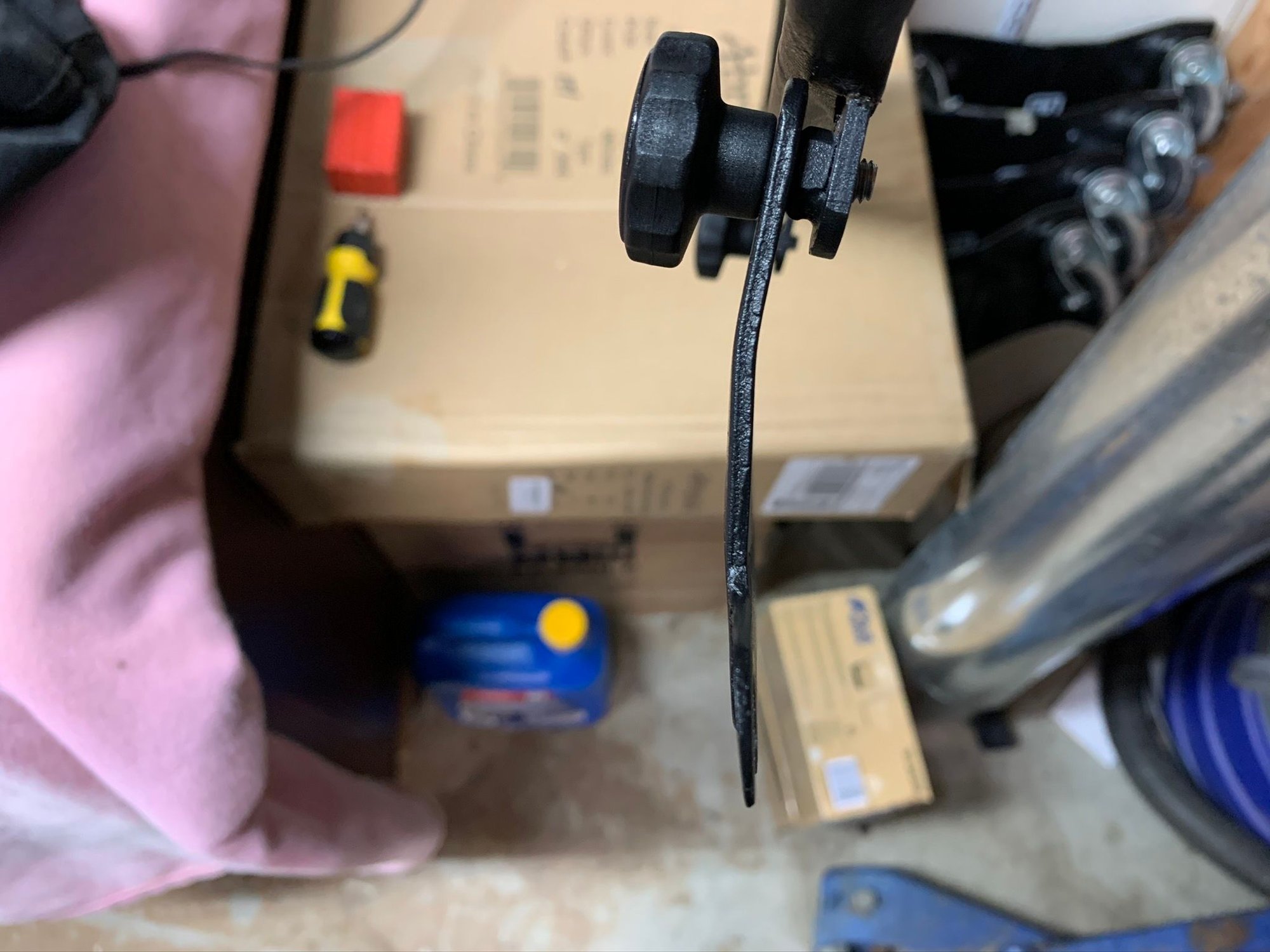

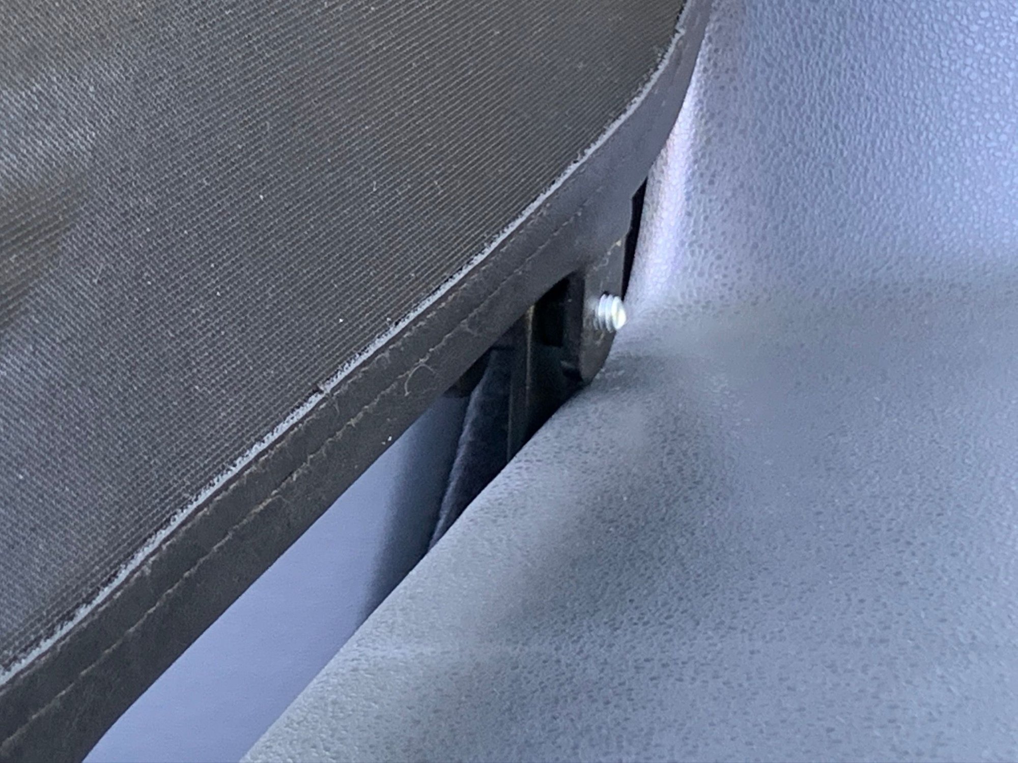

Just picked one of these up, around 200 shipped. Seems like great quality but the parts are not lining up and the company hasn't been helpful. Either the brackets are too short or possibly bent too far, does anyone with this screen have a picture of the brackets or be able to measure their bracket length?
The brackets aren't coming down far enough to rest on the hook screws, and the nuts on the screen are hitting the plastic trim. After emailing back and forth company says my hooks are too low from the factory, which is balogna

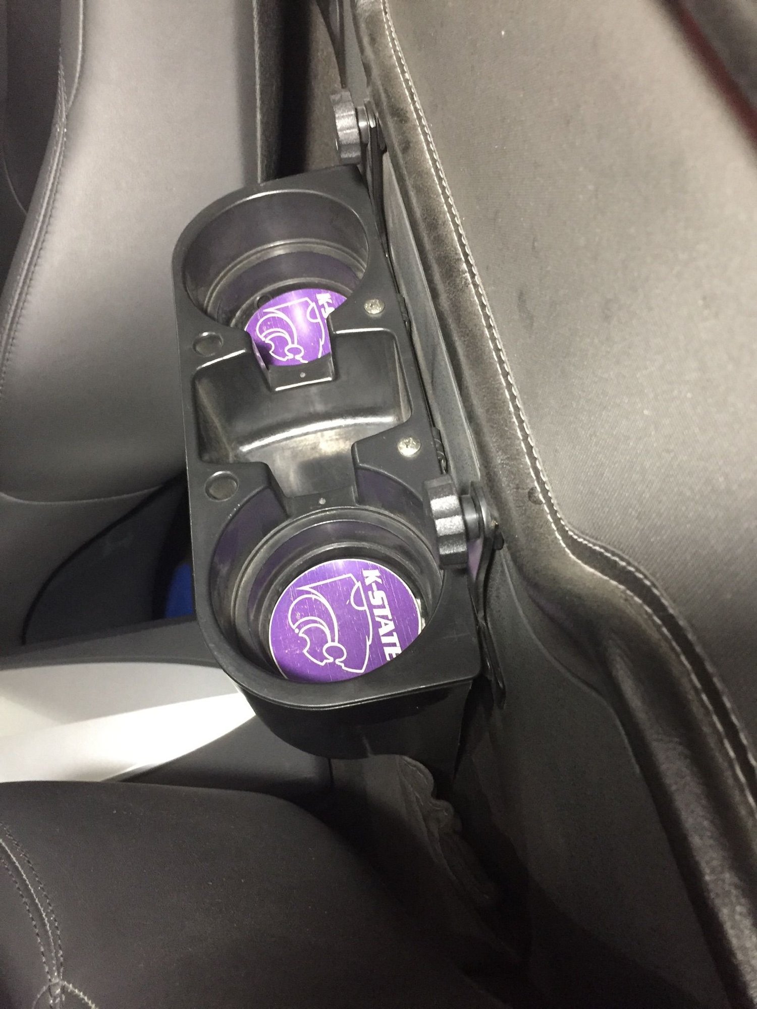

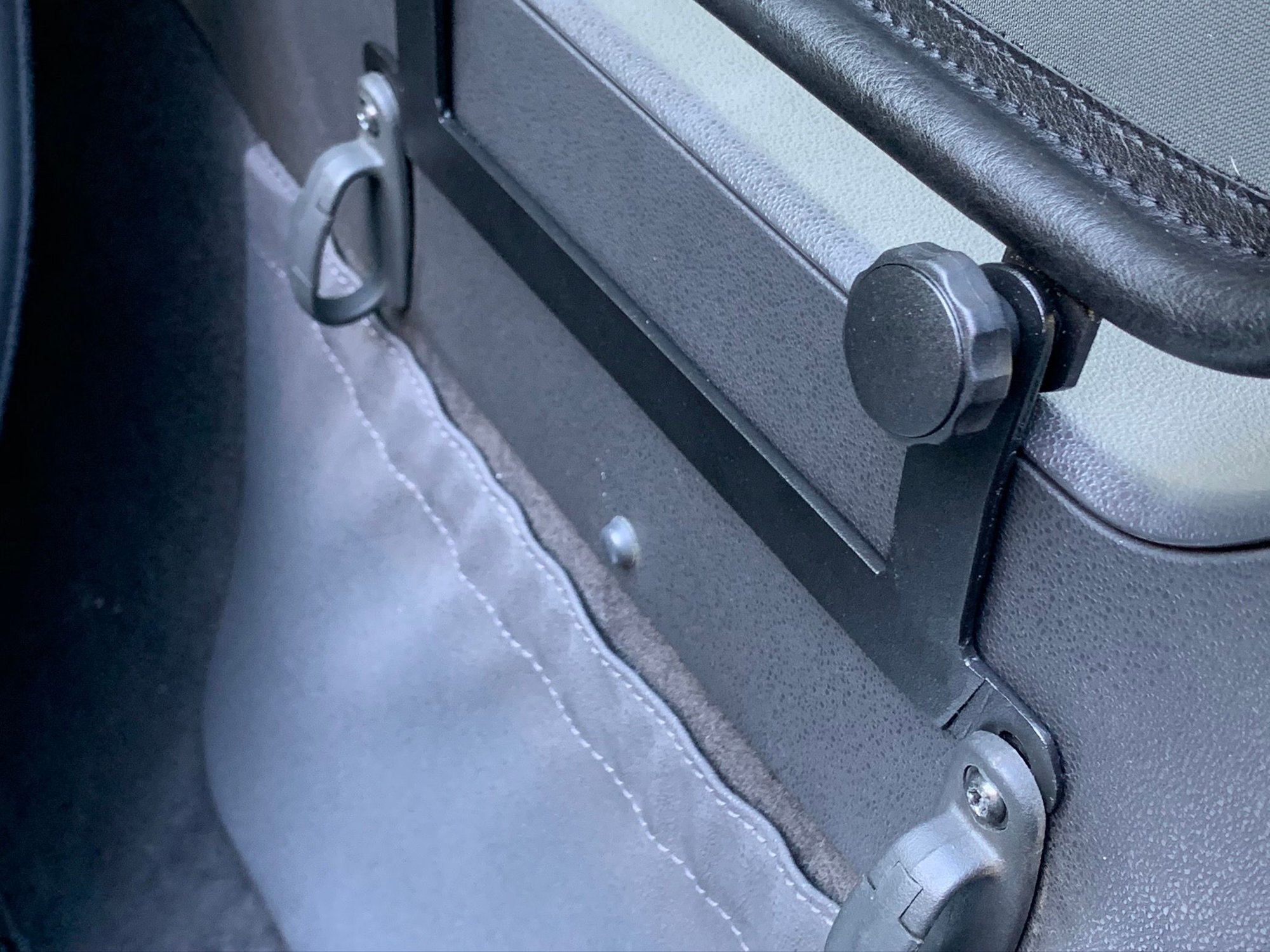

I installed the windscreen with the nuts on the backside. This allowed the slots to fit firmly behind the lower screws.

See I tried that, but the screen sat further forward than I wanted, I was hoping to see it flush against the roll bars. Maybe my brackets are shaped slightly differently from yours

The windscreen is snug against the driver’s side roll bar and about 1/4” from the passenger’s side. That may be due to leaning the seat back too far too many times.

Thanks for the pictures DKA! I actually had mine attached the same way as you, my last picture was just all possible combos to see if it was me or the screen.
