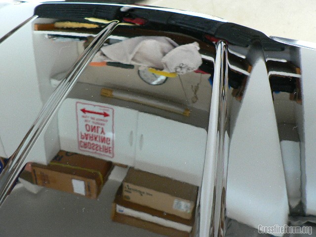

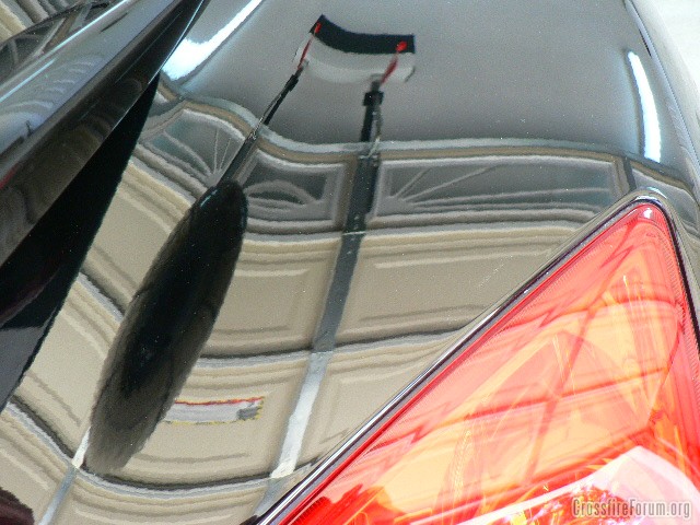

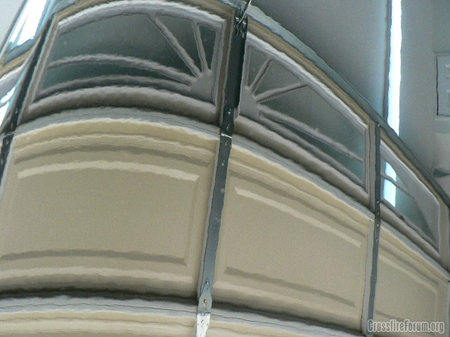

Old Aug 24, 2007 | 01:33 PM
CrossfireLTD's Avatar
Joined: Aug 2004
Posts: 2,443
Cool Re: Watermarks on black paint
SRT6 & Patpur are right...Porter Cable 7424 if you do not own one it i ell worth the expense. They only difference in my regiment is that I use Meguiars Final Inspection after I wash. Do not be afraid of the buffer it is easy to use just follow the instructions and use QUALITY products and you will be fine. Also Autopia and Autogeek are great sites with ton of info and advise.
http://www.autopia.org/
http://www.autogeek.net/po.html

Old Aug 24, 2007 | 02:55 PM
apkano's Avatar
Life is random...so am I.
Posts: 3,433
Default Re: Watermarks on black paint
Your car looks beautiful CrossfireLTD...
Just one question...what are those UGLY stickers on your window?
