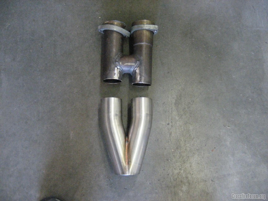

finally got our header flanges back from the waterjetter and they came out fantastic, i had a nice 304 ss muffler picked out but im seeing similar looking ones on ebay for next to nothing and didnt want anyone to think there getting a $30 ebay special muffler so ill probably pic out another so there wont be confusion down the road. btw, ours is not an ebay muffler but im guessing the ebay ones were copied off this setup. well let me know what you guys think of the style of it, the system will have a small resonator aswell since the new muffler will undoubtably be louder then stock and i think we will need a resonator to keep the tone in check (ill probaly make it removable with a swappable strraight pipe).
give me some wish lists here from the start please, so far we should end up with 1.75" primaries, to a 2.25 or 2.50" collectors, merging both banks into a 3" all the way back, we can set it up from the get go with quick change cats/cutouts/straight pipes by just adding properly placed dissasembly flanges.

What am I seeing here Rob?
I see a 2-in-to-one merge collector (I already have one one those)
Is the last piece the exhaust tips after splitting the single back into two pipes?
Where is the header set and the resonator? I am big time ready for some headers.
Any prices??

The last two pipes are the muffler(s) with a 2>1 3" collector ahead of it.
Looks good rob, but I'm anxious to see your header designs.
The removable cats and resonator would be cool as long as they weren't a big PAIN in the **** to get to and remove. Otherwise you may as well make them permanent.
Are your headers going to be LT's or shorties? Unequal length I presume?

wow, i looked around burn's website and they looj way expensve IMO, we deal with http://www.woolfaircraft.com/index.php for all our tubing and mandrel bending, our srt6 intake pipe was in thier SEMA display
the header i have in mind are short E.L. tubular to a larger flange setup (stock downpipes wont bolt to it or we would be wasting our time with the header). i think going long tubes would move us back too far for a cat to be effective (if you guys want to run cats?).
