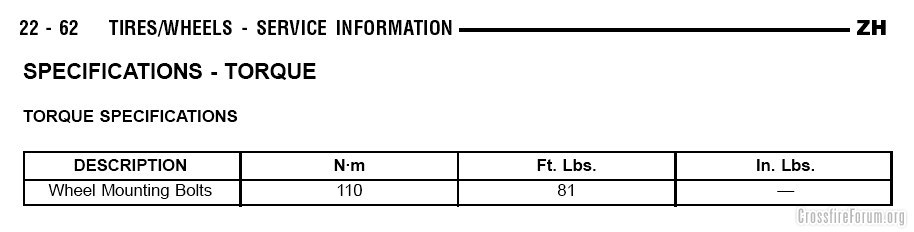

81 ft-lbs is correct.
This comes from page 22-62 of the SRT6 service Manual.

81 is correct, and as a side note new lugs are $ 7.00 a piece from your friendly Chrysler dealer. I take my wheels off a lot and had "assumed" 100 was good til I stripped one and then bothered to look it up and it is 81 lbs
