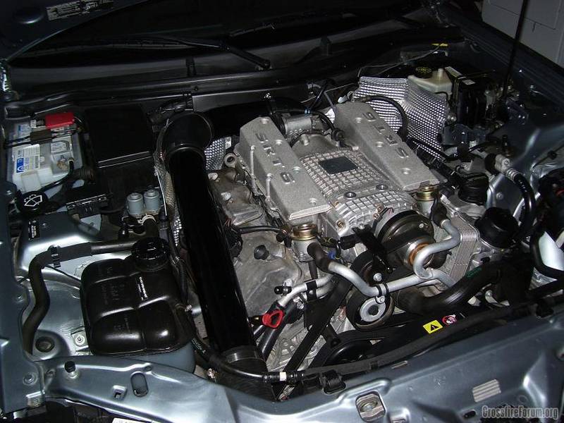

today I made a full 3" single intake
Old May 14, 2008 | 12:39 PM
Posts: 6,714
Likes: 454
Default today I made a full 3" single intake
I was looking at the prices for the intake and just made my own and can make one for you so if any one wants one i can make them,, right now just the single but may do the duel later see it in my galery also in the for sale section this is the prototype I will be making a change soon to only using onw coupling,also for mount instead of the two couplings jim

Looks sharp AMX - nice mandrel bends - is that chrome or polish?
Old May 14, 2008 | 01:00 PM
Posts: 6,714
Likes: 454
Default Re: today I made a full 3" single intake
polished alum.

Nice work. I made my own a while back as well using 3" pipe and an AEM Dryflo filter. I had it powdercoated gloss black once I got it all together. I would love to have some gloss black Needswings intake manifolds to set the look off.

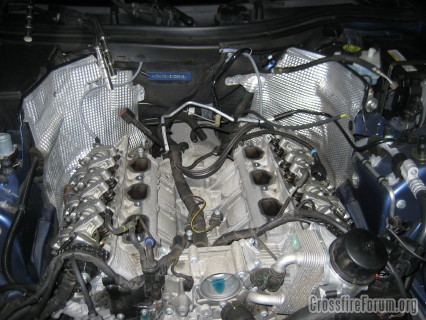

check out what one of the guys from the MB forum did...Powder Coated the manifolds anf the supercharger!

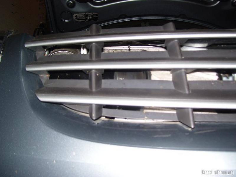

try to get the filter in front.
