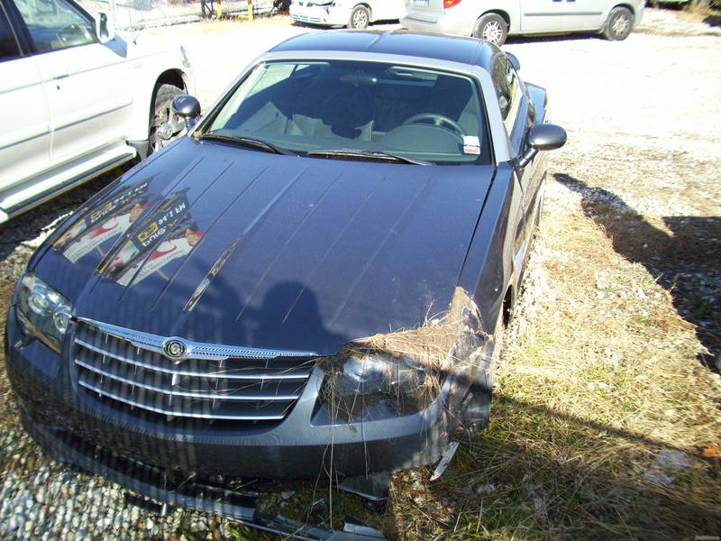

I was cruising down Hwy 94 past Defiance with a buddy of mine enjoying a night off and this happened.
Now I'll give you my story . I never much liked the Brake assisted stability control on this car it just never felt safe or right to me so i always turned it off. That night I had driven over 30 miles up and down this common twisty area to me. I decided to slow down considerably and turn on the traction control and just get used to driving with it on so i knew what it felt like.
It must of malfunctioned. The first turn i went around it caused the accident. I braked pretty hard before the turn so i would enter it at slower speed than i normally would have. It was actually only 5mph above the posted speed of the turn. The car made a unnatural jerk and then continued into a forward slide. I made a last effort to keep the car on the road by turning hard on the wheel and tapping the brake, which had no affect. When i applied the brake i felt the car was already braking! I realized at that point my braking and steering meant nothing to this vehicle and it had a mind of its own.
I will be taking pictures of the tear down and progress at the body shop Monday and let you guys know what was damaged.
Also I spoke with a lead mechanic at king dodge/Chrysler and he told me that this is not even close to how the stability control is suppose to work and wouldn't mind checking on the vehicle after it gets out the shop and tearing down the car to figure out whats wrong.

Ok. Now fix the pic links and yer good!
Glad we got "the rest of the story"!
Old Dec 5, 2008 | 08:51 PM
tighed1's Avatar
Posts: 5,741
Likes: 98
From: Sierra Vista, Arizona
Default Re: Snake Pit Accident
Too bad you fixed the picture links! I didn't need to see that!!!
OUCH!!!

Your experience reminded me of this link...
https://www.crossfireforum.org/forum...ad.php?t=28835
Read it and see if it sounds familiar.

SORRY about your car man! Bad deal !
I hope you & your buddy are all ok!
It looks like the car can be fixed.
I saw one yesterday in the pic gallery that
didnt look good at all. Nice that the chrysler
guy will look at it when its fixed.

Thats very similar to what happened to me. The car continued to brake and never left off. The air bags didn't even deploy i dont think we were going fast enough, it was the slowest crash in history. I'm sure if someone had a camera it would of looked like i just drove off the road at 50 and never turned. I wasn't scared at the time just highly annoyed afterwords, having no control over where you car is going is not a pleasant feeling.

The body shop said they would have it good as new for me . As long as the paint,body, and 4 wheel alignment come out perfect i will be that much happier
It might be better then new now, a good frame rack can do wonders.

Wow what is going on here? Is this system actually failing? Or is something designed to keep the hairdresser clientele who buy the slk320 to keep them from being bingoed actually helping to bin more experienced drivers?
From my experience when I leave on all TC and push the car hard into a turn, all it does is significantly decrease my corner speed and bog the hell out of the car with the brakes.
Damn... Glad you're ok at least.

This sounds like a black ice incident, what kind of temps you have there?. TC is not going to cause a "forward" slide or cause the steering to not respond.
Sorry about the damage.

from reading responses to my similar problem (?) - the best practical advice i heard was "DONT jab the brakes with a very quick motion" - the computer doesnt like that, thinks youre about to crash, and keeps brakes applied for a bit of time even if you let your foot off. Maybe also just watch it in general with the brakes and treat them with as light a touch as possible, they get scared easy!
From eleventeen
Most likely the brake assist (BAS). Basically, during a panic stop, the brakes apply full force (automatically) even if you don't push the pedal all the way down, or if you let up to reduce brake force. The computer senses how quickly you push the pedal and recognizes it as an emergency situation. Mercedes believes that drivers sometimes under estimate an emergency stop and wait too long to apply full brake force; the car steps in and does it for you.
"The Brake Assist System (BAS), an electronic system by Mercedes-Benz, interprets the braking behavior of the driver and initiates the full braking effect when it identifies an emergency situation. This reduces the braking distance substantially.

so my understanding is that this is neither ABS, nor is it TC - its BAS

Some cars disengage the ABS if you "tap" the brakes or so I've been told Could this have been the case ? What were the road conditions ? Just curious as to why the thing went into a power slide and not correct itself.
