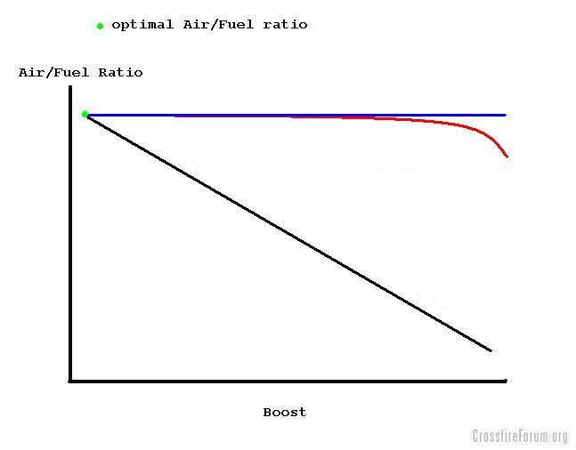

Originally Posted by tom2112
OK, I read all of that and still don't have a clue. Someone wanna give me the "for dummies" version?
Tom,
My engineering skills are nowhere near as advanced as Woody's, but let me see if I can decipher into a 'for dummies' version, as you put it.
So here we have a small graph... The Y-axis is the Air/Fuel Ratio (A/F) and the X-Axis is Boost. Now the bottom left corner of the graph is "0" and the values increase as you move outwards along both axes (NOTE: sorry about the green dot, should be on the y-axis representing 0psig boost)
Moving on. The black line is the current results of the a/f ratio as boost is increased towards woody's 20psig. As boost increases the a/f ratio decreases because the fuel delivered to the engine is basically the same (non-linear increase in relation to boost across the entire spectrum) at all times. This is not necessarily good as when higher boost is reached there is not enough fuel in the engine for proper combustion.
The red line represents Woody's current situation (correct me if I'm wrong Woody). With the addition of his FPR (fuel pressure regulator) he has helped to increase the A/F ratio average across all boost. Now as Woody stated he still sees a lower A/F ratio at full boost then he would like to see. So this is the cause for the drop off at full boost (however, the actual A/F loss may come at some other point in the boost curve)
The blue line is the ideal A/F ratio across the entire boost curve...This is what he Woody is ultimately striving for to maintain peak engine performance and fuel delivery at all times....
Looking back that may not have been 'for dummies' enough....
Basically, you want an A/F ratio with little variation at all amounts of boost. This is what woody is working for.

Talking Re: Yes, I do feel like a lightning rod - MY OWN TUNE.
Pretty much correct.
From Idle to 17 PSIG boost I am rich, I need to pull back on the fuel rail pressure so that I could lean there also
Now I will be lean everywhere. THe car fuel air ratio I ment.
Now with the controller "man-ing the rudder" the WOT will be sensed with the Zietronics data logger, and if it is lean, a control will increase the pressure signal to the fuel pressure regulator. THe FPR will increase the fuel pressure causing more fuel thru the injector and reducing the lean condition up to the alarm 'setpoint'. I should be able to control the setpoint and have the data logger drive the fuel rail pressure to give me what I want say 12.5.
I know that the s/c boost will just overdo the fuel mixture as I was 17:1 before I added the boost signal to the FPR. After the hose was added, the F/A readings fell to about 10.7 to 1 !!!!!!!!!!!!!!!!!!!!!!!!! That is way way rich, meaning I can go from lean to rich just by adding a CONTROLLED boost signal to the factory fuel pressure regulator (FPR). BTW the book is wrong as there is no return hose from the fuel system rail, everything is done inside and at the fpr under the passenger seat area. Inside that big plastic cover just front of the axle on the passenger side.
As the computer used to say "WORKING" , more soon.
Woody
