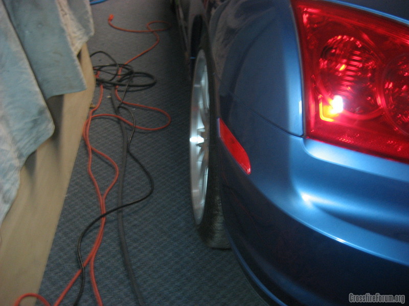

Old Apr 29, 2009 | 10:01 PM
BrianBrave's Avatar
<--- Huge Horsepower
Posts: 3,217
From: So Cal
Default Re: Alignment & Camber Kit
KMAC Rear Camber Bushing W/Extraction tool
Rear Camber Bushing installed
Rear wheel after alignment (nice...)
