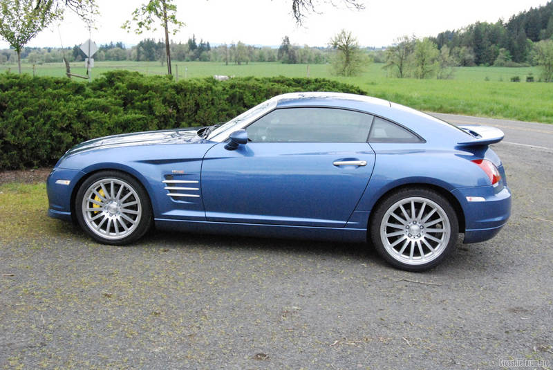

I put the wheels back on the Aero and took it off the blocks so I could see how the new Eibachs look and then took it for a drive...... The front is about perfect for me.... I have 10mm spacers in front to clear the C32 calipers.... the back could go down another 3/4" or so..... I am planning on putting 285/35R19 on when its time for new tires later this year..... I dont notice a real difference in ride or handling, but I was just driving on the highway....

The front looks good! With larger rear tires next time, it should fill in the wheel openings very nice.

Looks nice. Did you put spacers in the rear?

Nope.... I'll wait till I put the bigger tires on and see if it needs anything in back..... with 285's I dont think it will.....

I bet it will look kick-a-s-s with 12mm in the back.

Looks great not to mention the brakes!!!!

Looking good..now get that **** down with the front and perfecto!

Looking good Mike! I think you'll find that your car rides better with the Eibachs. I couldn't tell for sure about the handling, positive or negative, but after several trips to the race track it became clear that the car was slower with the Eibachs. Not much, and I doubt most people would notice but still slower. Most people love them and I think you will too unless your participating in HPDE, Solo 1 or autocross events. I can't think of a better spring for the street, but even the stock springs are better for the track. At least in combination with the Koni's.

They are factory SRT wheels......stock sizes... I have Koni adjustable shocks in the back and stock shocks in the front (for now).....
I also used the stock spring pads in front and back... I will get the 1 dot pads to replace the 3 dot it has now... that will get the back end down another 1/2"?

pad difference is 8mm. converts to .31" for the drop mike

It seems to work for those who have gone with the 275/35 or 285/35... as you can see, I still have a lot of room under there and it only adds about 5/8" to the inside and outside....more tire outside the rim..both sides...
