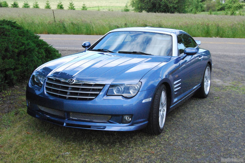

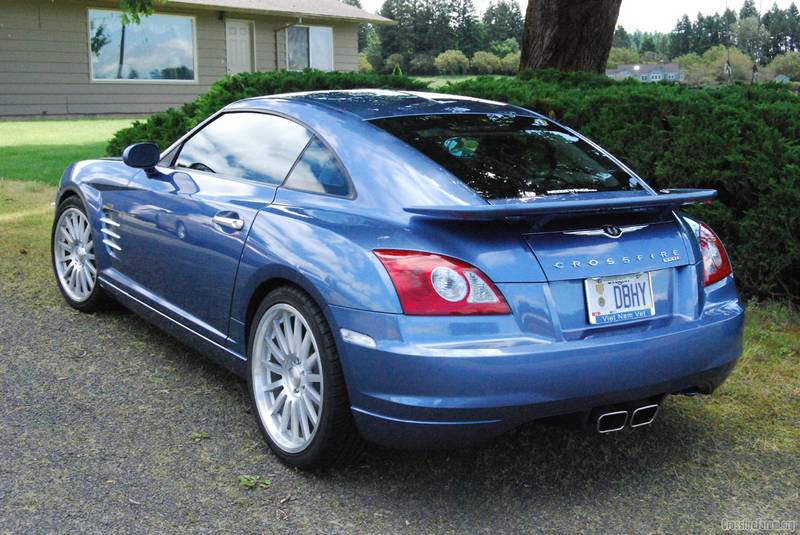

I just finished doing mine. I actually did the springs a few weeks ago but needed to change the rear spring pad/isolator from a 3 dot to a 1 dot to get it lower in the back. I also added 12mm spacers in back. I had already added 10mm spacers in the front for my C32 calipers. So here are the pics of how it sits now with stock tires and wheels........and a fresh bath from the local high school pep squad......
Tools: spring compressor, 17mm, 19mm and 10mm socket and ratchet, 19mm wrench. Having a medium sized philips screw driver is handy for alignment of holes......
