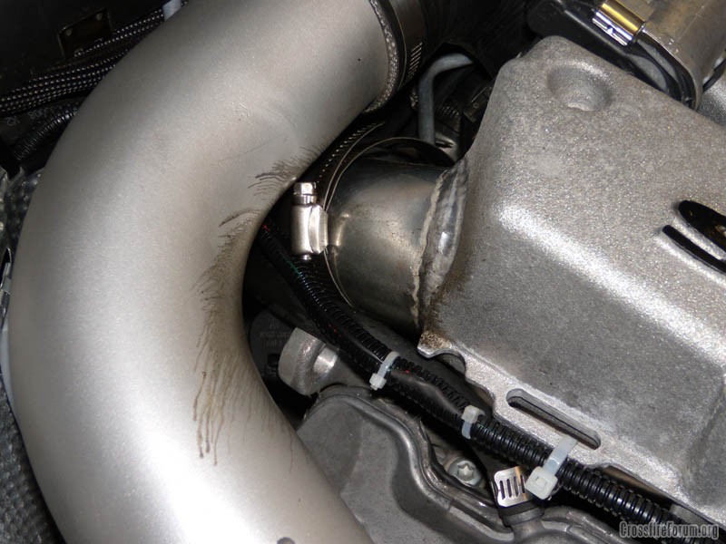

especially if you are at the drag strip! I went to the Friday night fun drags to test the Wavetrac LSD last night... one run and done!
13.54 @ 103mph.... loud squealing noise, CEL with P0300, P0302 & P0306 (multiple cyl missfires, cyl 2, cyl 6) and MIL status ON. The car is running normal coming back and seems fine when shut off and turned back on. Pop the hood and look around and see light oil spray on the passenger CAI... Time to go home. I had the data logger running so I look at it when I get home.... 11psi max boost.. I pulled the CAI this morning to get a look at the Y pipe and found the top clamp on the passenger side sitting up next to the intake plenum.. WTH?
When I went to put it back on it wouldnt stay... kept sliding off. Cleaned the rubber adapter and clamp with Naptha and then everything was good. Back on and tight...
The adapter pieces are 3" long and could use another inch to give the clamps more area and not be on the edge. Time to shop for 2 1/2" tube... of course I have a foot of 3" tube...
Maybe I'll get a better day next weekend... but it will be in the morning so it wont be 85 degrees! Unless Friday night is overcast and cool...

Doc, it wasnt my CAI clamp that came off... it was off the Y output from the SC to the plenums....
I got it fixed this morning and then went out and bought some new tubing so I can replace the ones I have with ones that are longer and can get a better clamp (with margin)...
I tested my fix on the way home...... I still had the DR's on....the tires squeal a lot and both sides... no more funny sound coming from the engine or loss of boost..... next weekend I will get a good test of the LSD at the track.....

mike ditch those crummy hose clamps and use the t bolt clamps. cost more but lock down and doesnt come loose

PS T-bolt clamps are a must for anything under high boost.
