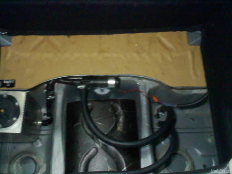

Default Re: BIG trunk-mount Intercooler ICE TANKS
Did this a few years ago when I had my car and it worked well at the track. 1 Gallon RCI fuel cell with johnson Cm30 pump mounted where the spare tools/pump used to be. Still had 100% trunk space avail and was all hidden by trunk mat/cover.
Its still there and works good
