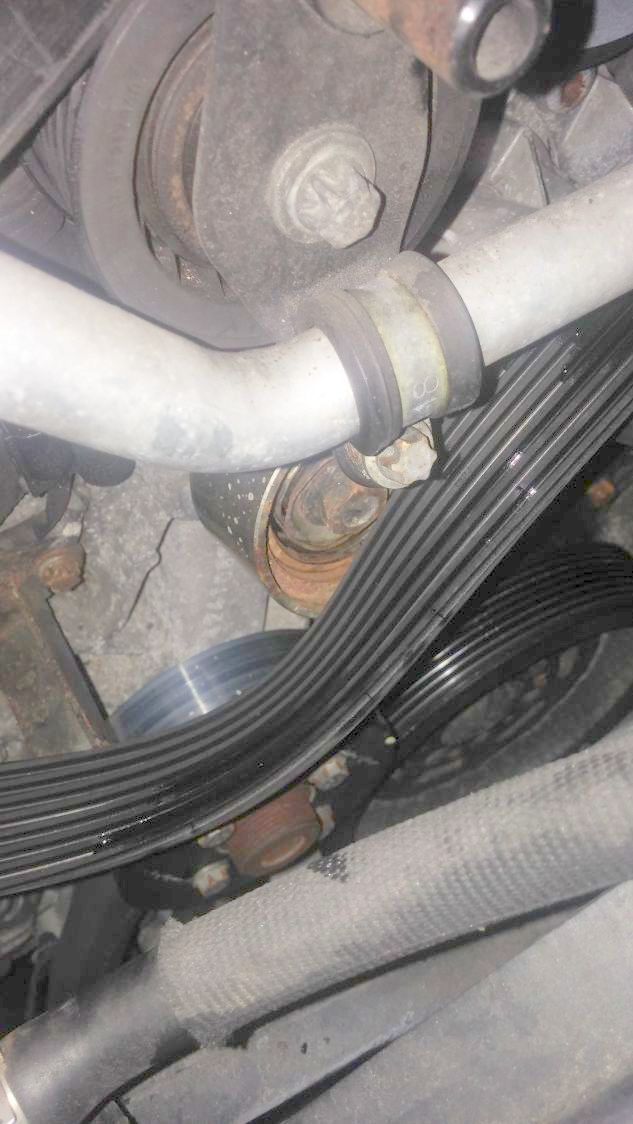

Theres the culprit i think. Comes right off. Unfortunately the belt if off now.

Looks like you have a larger crank pulley from that pic. You'll have to contact Rob at NeedsWings to make sure you get the right size belt. I wonder if that's a 185mm crank pulley?
Yup. Sure it. Eurocharged stage 1 pack.

Agreed, I've been there too. I had a hairline crack at the coolant plastic tee fitting returning to the coolant tank. It only spit when I ran real hard (autoX). At WOT,off,WOT, and with a little hot coolant on the belt; PRESTO, belt slipped/jumped off. I replaced with barbed brass tee. As Chuck mentioned; find your leak and fix. And yeah, order the proper belt from Rob @ N.W.'s. And depending on the mileage, you may need a new belt tensioner perhaps?

Default Re: Steering went out on the highway. Wtf??
Sure looks wet to me.

Tow truck just dropped it off at the tune shop. Guy there took a look and mentioned a new belt tensioner. Also the belt is a 185 eurocharged. Or rather was. Now its a scored belt. Will need a new one.
In addition to the wetness, it also looks like AGE related cracks on the belt.

Looks like it's been leaking awhile, a lot surface rust on your idler pulley just above the water pump pulley.
