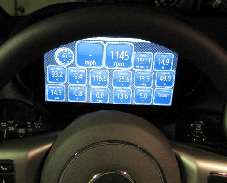

Key is to instrument and keep a running log file of the various parameters that could cause the problem. Most of the possible sensors have already been listed.
What you need is a mini Bluetooth OBD-II dongle, an Android smart phone or tablet, and the Torque Pro app. It can be set to record quite a few parameters is a .CSV file about once a second.
Just need to keep it running until it happens, then review the parameters around that time. Something is going wonkey.
Is a lot easier now than when we needed a mile long corridor to unroll the Brush charts of a flight to find anomalies.

Is there a reason you are not willing (or can't find a 15 year old nerd) to instrument it ? One of the things you can monitor is the throttle position sensor and that will tell you quickly if the signal is getting to the computer. You can also compare the TPS to the actual throttle opening to see if the throttle body is matching your request.
Sounds like people have just been throwing parts at is and that is not the way to diagnose a computer car.
