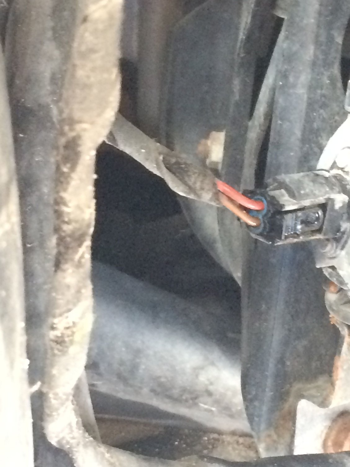

Sorry the 2 wires cmg from IC pump are red and brown. Red and brown
Brown would be power?

BROWN is almost always GROUND, RED is almost always POWER.
Surely on our cars brown is always ground? Or all hell could break loose when working on the wiring.
Red would be power in that picture, but that wire could be any color or combination of colors.
