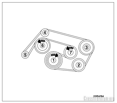

As far as the serpentine belt diagram, do you have an SRT or NA?
This is the diagram for the SRT:

Here is the diagram for your car:

You can download the service manual from here to get step by step instructions on the installation of the belt:
http://www.majormotorshotrods.com/_d...ice_Manual.pdf
