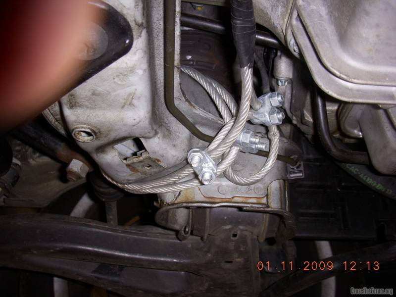

Remember that I used a SS cable to limit the motor mount flex on the driverside for stress, which I have been known to cause........Woody FYI

How could anyone forget your cable I need to find pictures of it and look at it again. My one concern when I first saw this was the stress on the SC.
I was looking through your gallery and only saw the picture of the cable wrapping around the frame but do not see on of it over the motor. Do you have more pictures?

The SC motor cable was just for the one day for the track, I went ot the SS cable and its still there. Woody

Waldig - can you post pictures of your new setup? I looked in your gallery and did not see them.

Waldig- Any chance of getting pictures of the way you have routed the chain?

I added a ss cable not chain and used it to loop over the motor mounts groove and under the frame support, motion I have - stress I dont there is slack 1" Woody
https://www.crossfireforum.org/galle...grade_0311.JPG
ENJOY< woody
Larger photo in the gallery: Fuel system upgrades (031)

Wow.... took a while to track that picture down! I will save the rest of you some time. Here ya go.

Thanks I saw that picture but was trying to figure out how had it wrapped. Now with the additional explanation about being wrapped over the motor mount groove I think I understand. Although I do not have the car to look at right now.

I haven't experienced this problem so far, but maybe it is just happening with the clutch/manuel transmissions. I did experience this in my younger years on my '69 Z-28. The rubber mounts wouldn't hold up. We cabled the torque side down. I had a cable made up with loops. I bolted one end to the frame, the other to the block with about an inch of play...never lost another motor mount... I did this with my big block '71 Camaro as well...same results. Any hardware can make you cable, and it is a cleaner look. I have even seen them chained down...
