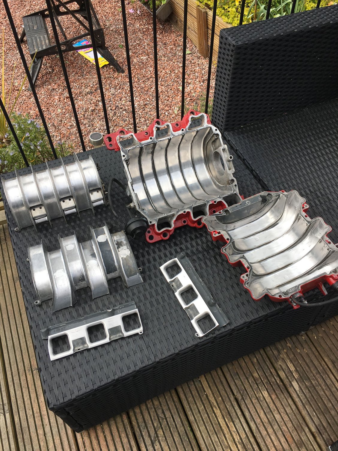

Old May 5, 2017 | 02:30 PM
Shaneth's Avatar
Joined: Sep 2016
Posts: 15
From: Yorkshire
Default Re: Intake Manifold Gasket
oh, and this is clean
