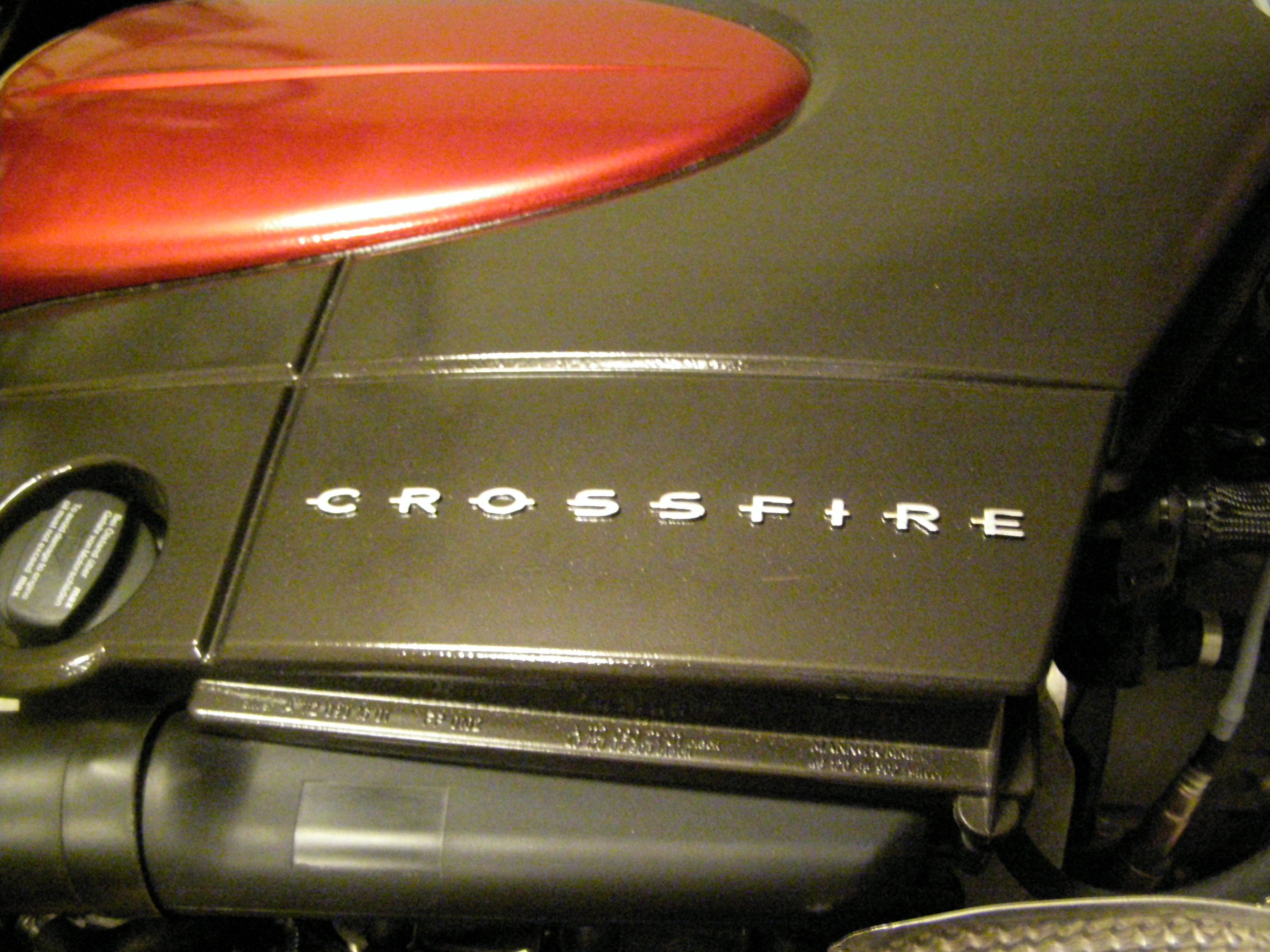

Painted the engine cover. What do ya think?
Jon

Did you sand it down, or just prime it and paint it? It does looks like a good paint job. Very glossy!

Jon - Very nice paint job there, you must have spent some time on that. What paint did you use, was it acrilic ? You'll have to give us some tips on getting such a super finish!
No primer, just a quick light sand down to key it. Then the colour. Lots of lacquer. Finish off with a 1500 flat down then polishing.
Cheers
Jon
Hi Steve.
Yes two pack lacquer on top. The colour was water based, this makes it easy to wipe off the colour that will cover the lettering. Lots of lacquer. After drying off it was hand flated with 1500 wet and dry paper then polished up.

Originally Posted by UK ken
Hi Jon
Great paint job,and detailing, looks the bizz. Are you changing your air intakes? as I noticed the chrome pipe & filter in one photo?
Cheers
ken.
Hi ken
Standard filters at the mo. Must be the way I took the photo.

Hi Jon
Don't want to be a pain, but do check out picture one. Looks like a chrome air intake!
Hi Jon
Cheers
Ken.
You were right Ken. Picked up the wrong image from some were! All correct now.

Originally Posted by peter02910
It looks great and I can't wait to do mine.
My only question is, isn't lacquer highly flamable? Just a question.
Very flamable in its liquid state. Once dry its only as flamable as the plastic cover filter box itself.
