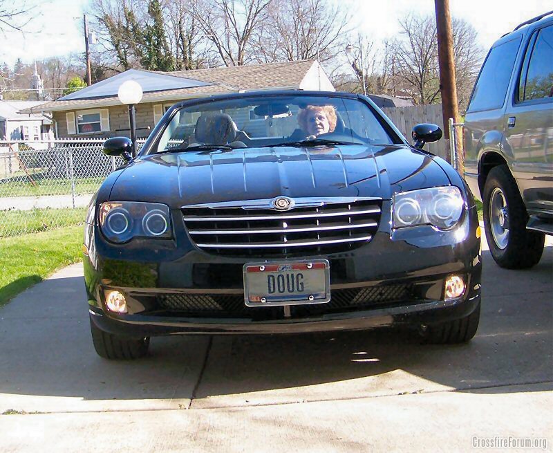

The fog lights was a complete success. about eight and a half hours for the total instillation. this included cleaning the front rims while the tires were off to gain access to the compartment where the fog lights are located. I think I will add a wind restricter for my next priject. sure is good to have a vast resourse for anything I want to do. I enjoy the forum as well as crusing in my 05 base roaster now that the weather has gotten better.
PS: That is my better Half Doodle in the car not this grey haired old man.
R DOUG C
