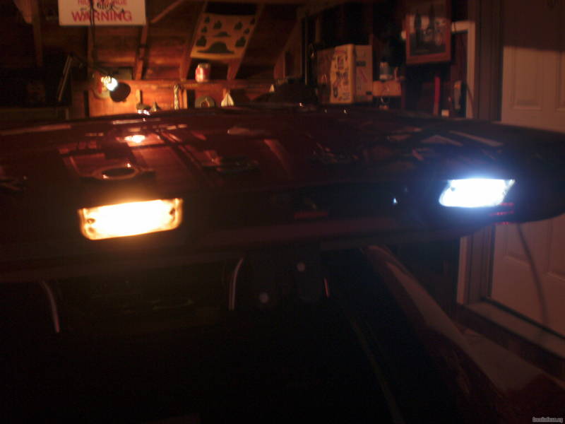

wow, for the price these things rock! Its odd though that they arnt encased in glass but are sealed up nicely in the housing. Hope they stand up to the trunk closing.
heres a pic of one contrasting with the stock bulb

WAIT UP. ok after about 10 mins my light out indicator was flashing on about one minute then go off for about 15 seconds. At lunch, I turned the lights on and waited for the dash light to go on. About 2 minutes, the canbus light (R/R) went out and the dash light came on. Im contacting the seller to see about the replacement cause I think its getting hot then going out.
The eyebrow light is a type 194, they are also sold by factorykiss
2x Car CAN-BUS Bulbs 36mm 2-SMD LED Festoon Light White - eBay (item 130429868726 end time Dec-08-10 00:32:42 PST)
I'm sorry I didn't see this post earlier, cause I just ordered a set to try them out. They looked good on the rear hatch pic. Damn China made shlock. Or maybe that one light was the only one in existence that will be a problem. I'm still going to try them out. Thanks for link. Bob

Yeah, Im sure its one that slipped thru their quality control but now Im getting 2 more for 3.99. The other one still works grreat. I hooked the bad one up ta a battery and when it starts to get warm it goes out, cool it off and it works again
