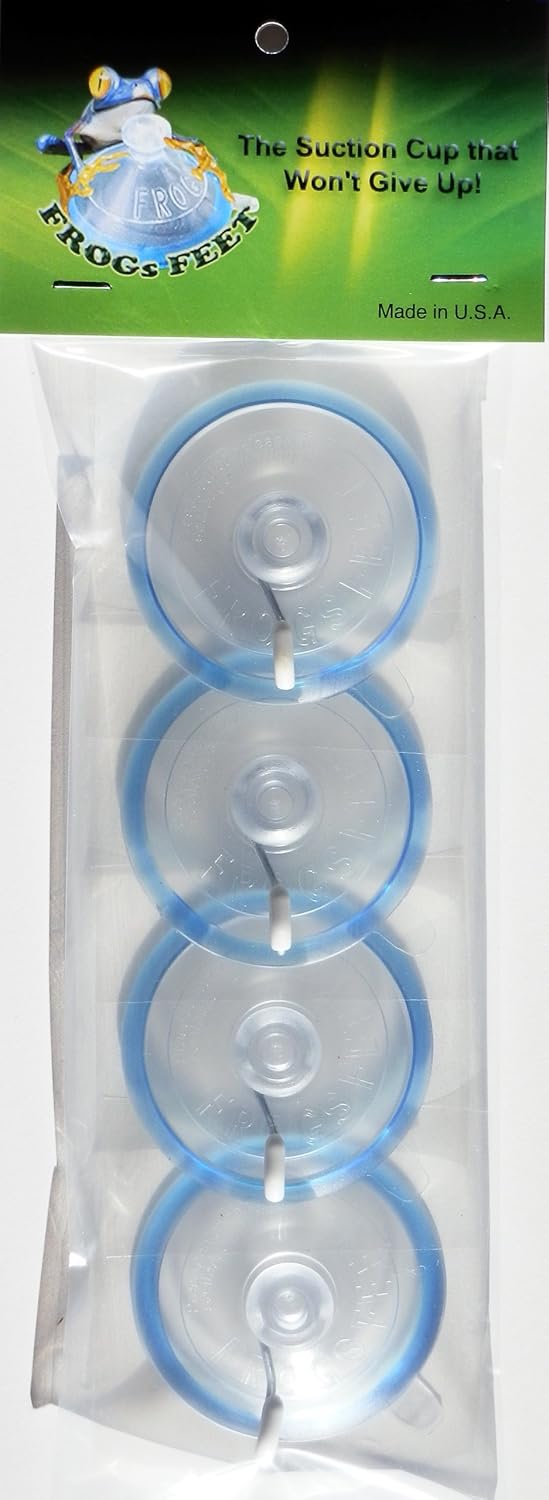

Then get these Frog Feet Suction cups off Amazon. These cups have some sticky reusable polymer on the edge and hold really well. Plus the diameter is just right without protruding past the edges of the holder.
Amazon.com: FrogsFeet Large Suction Cups with Hooks, 4-Pack: Office Products Amazon.com: FrogsFeet Large Suction Cups with Hooks, 4-Pack: Office Products
Once you have the cups remove the hooks off of two of them with some needle nosed pliers.
Drill two 1/2" holes in the recessed areas on the license plate holder. A Unibit works great for this.
Push the suction cups into the hole from the back. It's a very tight fit but a little silicone spray makes it easier.

These Frogs Feet cups really do stick. I decided to try them after reading the reviews on Amazon. And to make sure the cups stuck to the bumper I slid a butter knife behind the holder and pressed down on the cups. So far the license plate is holding in place just fine.

You should try the Frog Feet, the inventor had the same problem in his bathroom and that's how he came up with the idea.
FROG's FEET
Why FrogsFeet?
We developed FrogsFeet™ suction cups because regular suction cups that we were using on a newly designed bath product kept failing in tests on a presumably smooth surface. Upon closer inspection we discovered that the surface was in fact slightly textured, causing the lip of the cup to lose its seal and therefore the ability to maintain suction. After much development and testing we came up with a suction cup that makes just about every other suction cup obsolete. FrogsFeet™ have a revolutionary active polymer seal around the lip that conforms and bonds to a wide variety of nonporous surfaces, from smooth to highly textured. Combining the principles of suction and adhesion FrogsFeet™ can support more weight and tension by maintaining maximum suction over astonishingly long periods of time. They stay put in temperature extremes because the polymer seal compensates for expansion and contraction. They will not let go or slide in moist or wet environments such as bathrooms because the hermetic seal keeps moisture from penetrating the lip and entering the interior of the cup. This makes them ideal for prolonged outdoor use, in heat and cold, rain and snow. Regular suction cups will fail on all counts.
I imagine a zip tie could be added easily enough for extra security. Put two small holes centered along the bottom front of the holder an inch or so apart and wrap the zip tie(s) through it and around the center part of the valance.
