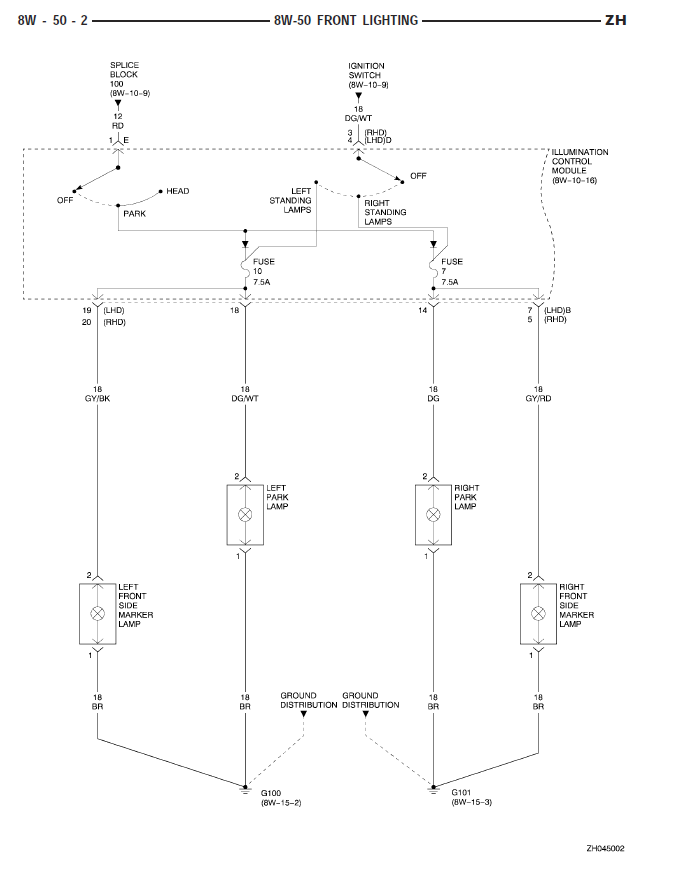

Old Nov 26, 2017 | 05:38 PM
Default Re: Where do front driver side parking light wires connect?
Here's the wiring :
Old Nov 26, 2017 | 06:01 PM
RobGionJr's Avatar
Joined: Nov 2017
Posts: 3
From: MO
Thanks for the diagram but I'm having a hard time following. Are you able from this to share where the wires that connect to the bulb socket start from? I'm simply hoping I could follow wire from that point to see where the break is or where wire is missing. All other electrical components and lights appear to be working. Thanks!
Rob

Old Nov 26, 2017 | 09:18 PM
Padgett's Avatar
Joined: Oct 2013
Posts: 2,152
Likes: 37
From: Orlando
BTW that is from the 2005 Service manual downloadable as a .pdf - can find in the documentation section. Troubleshooting is several pages starting on page 8L-32.
Old Nov 27, 2017 | 07:21 AM
Rob
The wires are in a harness that runs from the headlight switch assemble in the cabin, through the firewall and up to the headlight position.
