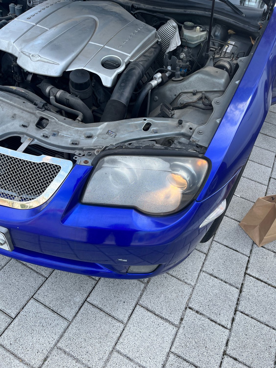

as many of threads for condensation, it is needed to buy a kit for it.
In South Korea, it is illegal to release a bolt to separate a lamp unless it is a technician, but if I get a kit, should I release the bolt to solve the problem?
Does anyone know how to buy a kit for headlight condensation?
Thank you.

My suggestion is to first remove the caps and the bulbs and blow dry thoroughly before doing what is described in the attached video.
Headlight T shaped drain tube - CrossfireForum - The Chrysler Crossfire and SRT6 Resource
