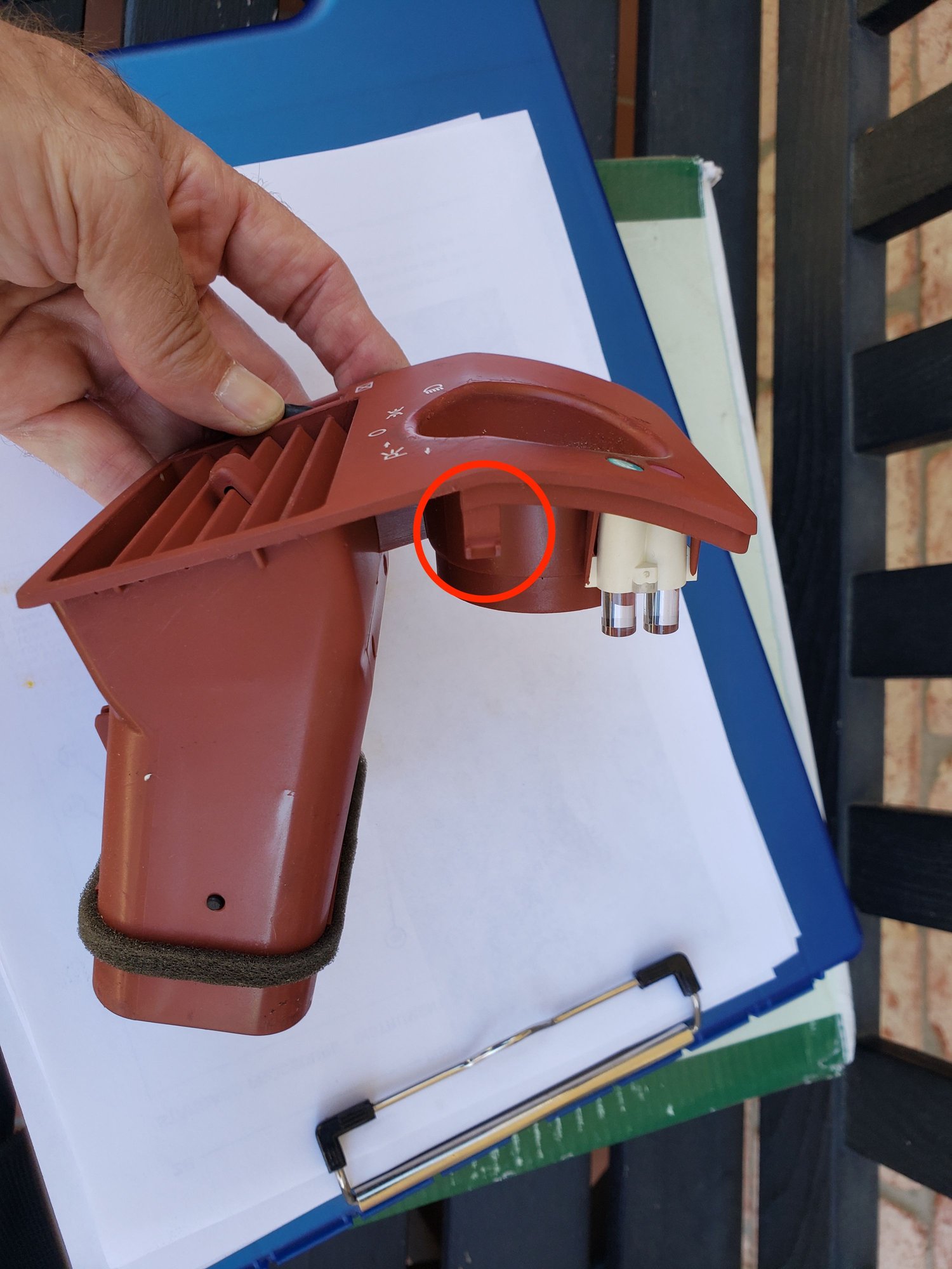

One difference between the SLK and our Crossfires is that the left air vent on the Crossfire is integrated into the larger trim piece and there is no screw behind it as on the SLK. I broke one of its two locking tabs during removal. See photo for location of the locking tabs.

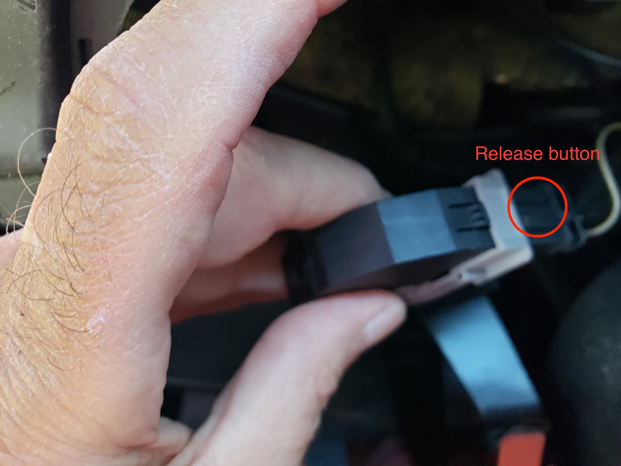

One tip, so that you waste less time scratching your head than I did, is the location of cable connector locking button--see the annotated photo showing where to push.
