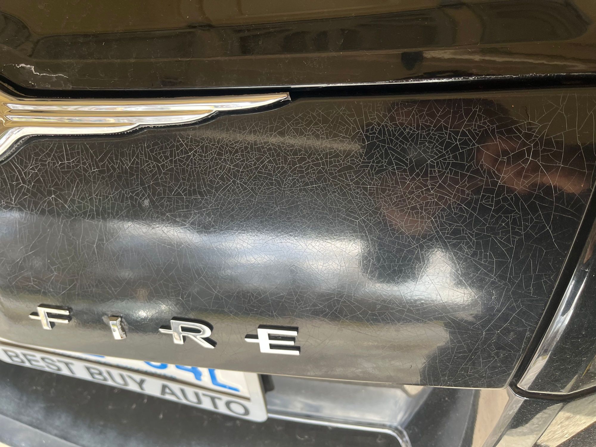

I have a question regarding how to fix the cracked paint on the rear hatch below the spoiler and DIY solutions?

Welcome to the Crossfire forum, with your baby Benz 'hybrid'. The document collection post will give you invaluable how to documents to downlead, an owners manual, and the factory service manuals (all free)! About the paint, depending on how much of that crackling, and if the paint is degraded anywhere else on the exterior, self help first (or a professional at a local paint shop that can match and has a great reputation).

Paint problem happens only on that rear panel. The rest of the car is perfectly fine so it's very strange why that rectangle paint cracked.

My experience with cracked paint like that would be a botched prior repaint. To do it right it would probably need to be completely removed and redone.

It looks like some of the clear coat is coming off the edge of the wing as well. Concur with Zeracer; That panel needs to be brought down to the primer and start from the beginning; May as well do the wing also as it is right there next to the cracked one.
