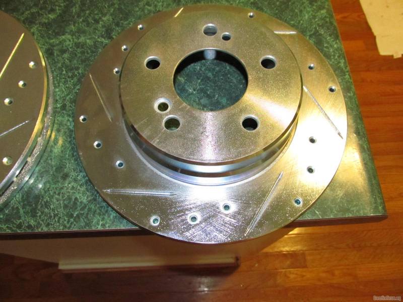

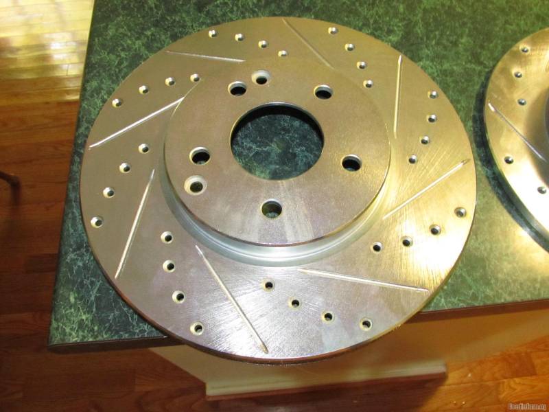

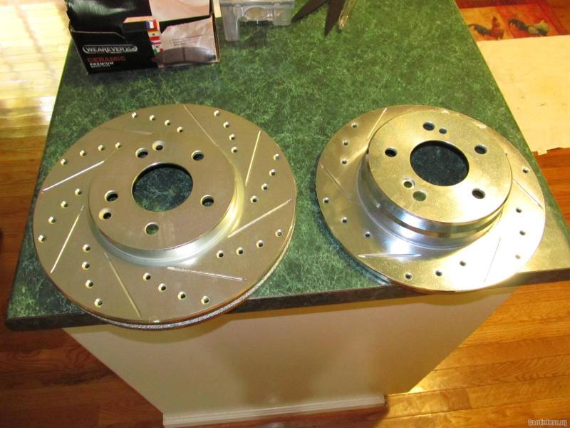

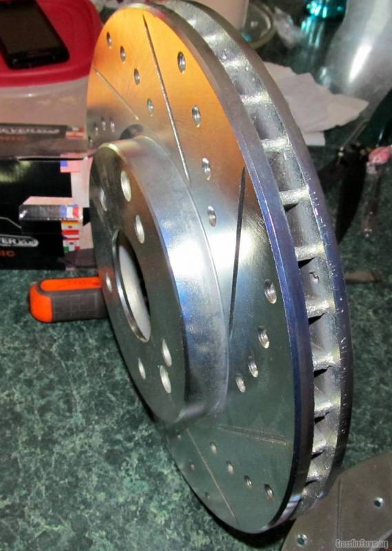

I wanted to upgrade my brakes for improved, cleaner performance. I decided to use R1 rotors and ceramic pads
The first thing I noticed is the mass of the front rotors as compared to the rear rotors

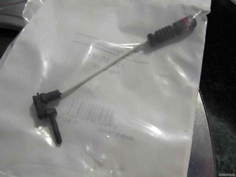

replacement sensors

The rotors came from R1 Concepts. They are the E Line rotors ("E" probably means economy) they arn't much more expensive than the stock replacements.
Front= $132.57 R1 Concepts front E-line rotor
Rear= $86.05 R1 Concepts rear E-line rotor
I noticed that the weight is listed as the same for the premium rotors. The sensor wires are $2 each so they are about the same as any where else
