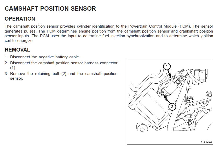

Can anyone tell me where the cam position sensor is located on my srt6.
thanks
Old Dec 3, 2016 | 06:19 PM
Default Re: CPS Location
Front right side of the engine above the alternator.
