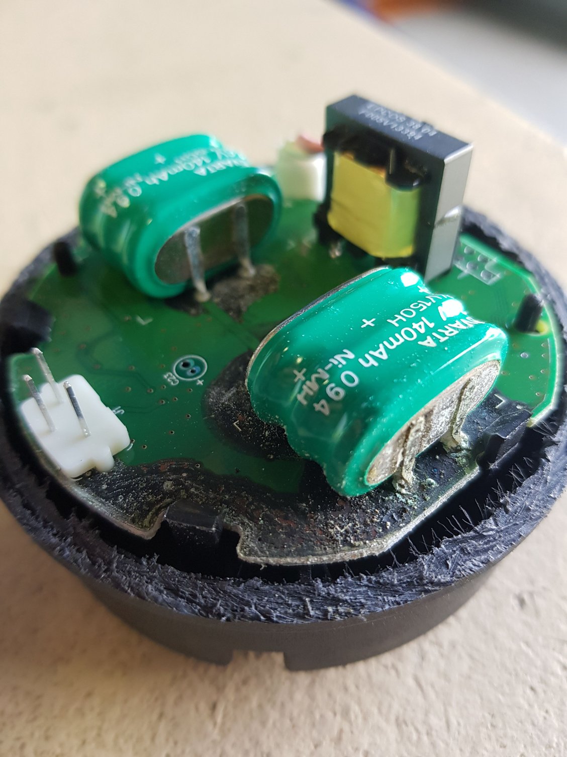

I understand you would prefer to change ther batteries rather than the whole siren unit. I had the same thoughts with mine.
However, i would say there's a 99% chance your circuit board is corroded beyond repair. I recommend you perform an autopsy on your unit to check ther circuit board before trying to source replacement batteries.
I changed mine a few days ago, photos attached.
Note: my car hard always been garaged and very well cared for so no crossfire is immune.
So does the siren have to be sawed apart as it appears in the photo or is there another non destructive way of disassembly?

It does have to be sawed apart. One advantage to a new siren is you can get one the chirps and lets you know it is locking / unlocking.

My siren didn't operate so I ordered new batteries thinking that I could just replace the batteries and everything would be fine. Here is a link to the batteries I purchased on eBay. https://www.ebay.com/itm/2x-Ni-MH-Bu...72.m2749.l2649
I took my siren apart and found, like everyone said, a circuit card ruined by the leaking old batteries. I just taped up the connector under the cowl and didn't install a siren. Car works fine without it. There are a lot of used sirens on sale on eBay but you could be buying a siren that may have a ruined circuit card.
Before you purchase any batteries take your siren apart, there is a procedure on the forum, and see if your circuit card is damaged. If so, a new siren costs around $140.00. Hope this info helps.
